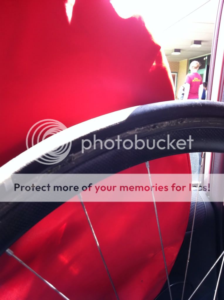

One other thing, if you choose clinchers go for one with an aluminum brake track. Budget all carbon clinchers don’t have the best track record for the rims not over heating and deforming.
Yea, my tubulars stink like a truck with bad breaks after a strong descent (cork rub-off?) Not something I was used tol. They get hot, BUT! Not much in the UK forums (that I know of) showing catastrophic failure related to the brake surface. PX has amazing customer service and pretty good warranties.
I really can’t speak to which mid to lower price all C clinchers have issues, but their have been many reported. Seeing as its likely to happen when going fast down a long twisty desent, it probably is a reasonable warning.
Agreed, but “likely?” Anyone have stories of carbon wheels (tubular or clincher) that had a brake wear related failure? Maybe I’m just lucky,… and cheep.
**Actually, a rear disc WITH a disc cover HAS to be the fastest rear wheel ever. **
Never said likely, I’ve also never heard of an issue with tubulars. L Zinn on Velonews did a test of the Zipp FC and mentioned that they were the only all C clinchers that didn’t have issues on his standard downhill testing. Keep in mind he lives in Colorado (I think) and is 6 foot 6in or so.
Nevermind, did a quick search. Seems like the issues are with no-name, no easy return type of wheels, Chinese, etc.?
I had a rear failure on a set of 38 CCs on a long descent that was part of a neutral roll out for the start of a race. Because of this everyone is going slow and if you have the wrong pads on and carbon clinchers you run into trouble. Looks like every year the guys with failures are running swiss stop yellows. I was fortunate enough to have a set on my ride and the rear pad melted and brake surface delaminated.
http://i560.photobucket.com/albums/ss41/stalkan/bd738583.jpg
Had I not been stuck in a slow pack I doubt there would have been any issues. I have since moved on from yellows and have had no issues.
