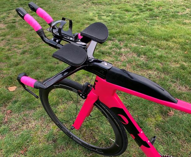

Here’s a shot of the Alpha One mounted up to my wifes PRfive.

How do you manage to hide junction box in the Alpha One ?
Hard to put 5 ports junction and wires… Any tips ?

In theory you can, see: https://www.tririg.com/store.php?c=alphaone&page=faq but I think individual results may vary. On my wife’s QR (pink bike above) the 5 port is hidden in a cavity in the front section of the bento box, so all wires run to it and the wires just pass through the Alpha One. I am also swapping my Shiv from an Alpha X to an Alpha One and so far no luck with the 5 port fitting. I have an Omega brake and terminate the brake cable housing in the Alpha One cavity and run bare cable down to the brake which means the cable housing is 90 degrees vertical and that cable housing pretty much makes it impossible to fit the junction :-/. I had no issues with the Alpha X but the cavity was longer so the junction fit in front of the brake cable housing. I need to play around a but I might need to swap to the new bar end junction A and just put a 4 port B junction in the Alpha cavity. I’ll keep you updated as I make progress.
One big help can be to cut off or file off the mounting tab on the back of the junction. Perfectly safe to do, and it gives you several extra mm of room.
Already done but Still very complicated😬
