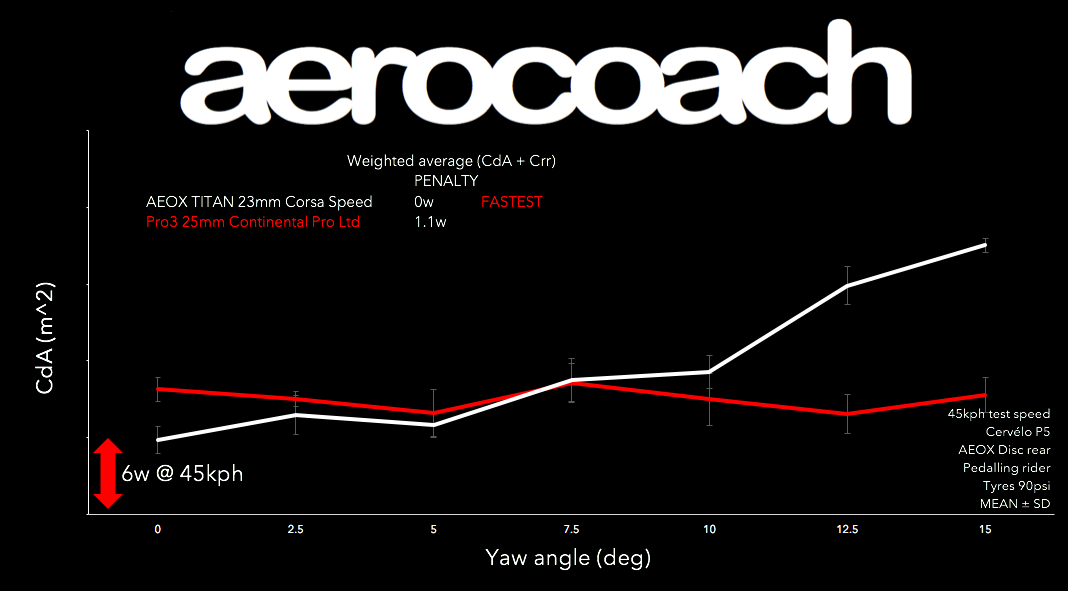

FWIW here’s our TITAN front wheel vs. a Pro 3 trispoke with a Conti Pro Ltd tubular (25mm - Shimano say you can’t use less than a 25mm):
EDIT - there’s a mistake in there as the quoted difference is just an aero penalty, not the combined CdA/Crr.

Well that sure doesn’t explain why the ProTour teams would use the Pro3, but it does look like the ultimate Kona wheel. Crazy that it would work so well at high yaw. Thanks for posting very interesting.
It’s a good wheel - there are lots of wheels getting used in the World Tour that are truly terrible! It’s also relatively light and the handling (which is what it was designed for as well as aerodynamics) is pretty good too.
They often are out of true however, and depending on the batch the hubs can be terrible - we’ve had some from separate world tour teams where the bearings are completely shot - which isn’t going to help. But aero wise they’re not bad.

Not the tubular version! That’s what we tested, the Conti Pro Ltd doesn’t come in clincher.
I’m almost sure the 23mm Conti will measure 25mm on the wheel.
