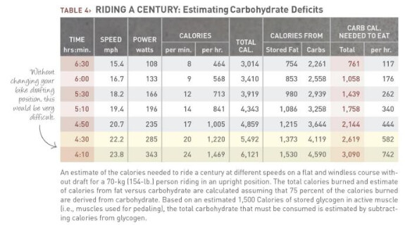

Again, in the writing he talks about sugar being used as a tool. If you try and replace all the calories a TdF rider uses in a day with solid food, he’d be on the toilet all the next day instead of the saddle.

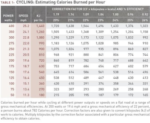

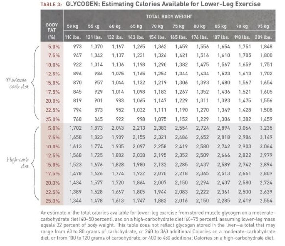

Some good charts from the intro of the book:
