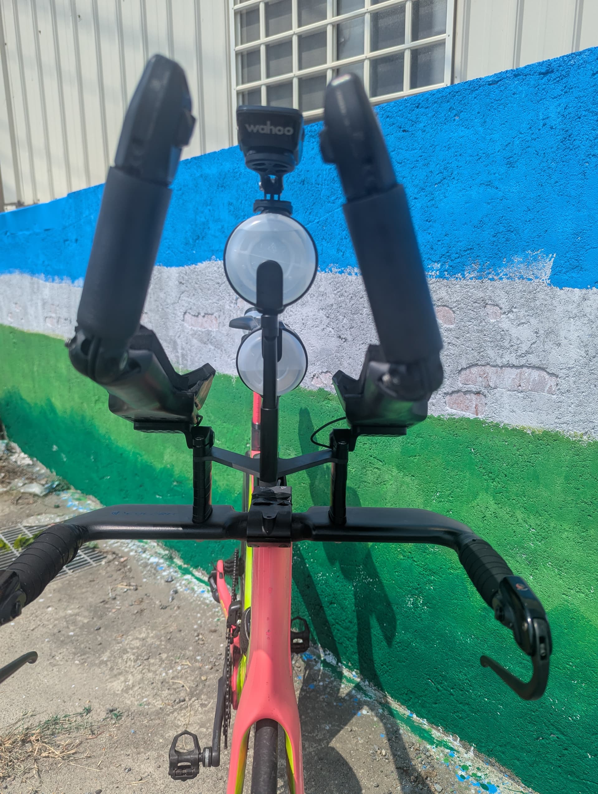

It’s not. Here’s my bike from yesterday with a new culprit 2 piece aerobar but same bta system
But I will likely be offering a shorter version that will help with different assemblies and Vanquish probably will benefit from a shorter model with less range due to where it mounts on this aerobar design.
