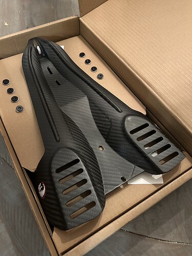

Thanks very much! Out of the box, the build quality is very impressive!
The underside is definitely not smooth, but, it looks cool. And looking fast is half the battle.

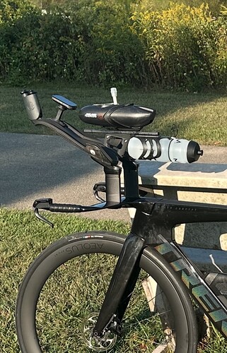

I have it for my Trek SC gen 3 and absolutely love them. highly recommend them. Light, strong, functional. very easy to install. I went the Mono and love the feel when riding outside.
I agree, I also have it for Trek SC gen 3 with the monogrip. The adaptor plate fit perfect and was very easy to install. Obviously this will not fit everyone since there no adjustment with the width but it fit me perfectly. I can stay in aero all day with it. The BTA solution and computer mount blend everything together. I have no aero testing to say if its faster or slower but it definitely allows me to stay in aero more comfortably much longer than other setups I’ve tried which is a win for me. Have no concerns with the safety of it, feels very strong and stable. Also the owner Marcos is great, had a few questions and he was very responsive and helpful.

I love it! It’s incredibly comfortable and stable. The bottle holder with a Xlab Gorilla cage works great. The Garmin mount holds the computer at just the right spot. It feels compact but incredibly comfortable, somehow like it was custom made for me.
I wouldn’t ever look for a different cockpit. highly recommend!
That said observations of the bottom being not very smooth (like the new Canyon release cockpit is) are right on and I doubt it’s faster than my prior PD aero extensions but I don’t really care. It will be fast enough and by fitness I could hit my race goals regardless.
Love the fit and quality of it. Very pleased.
