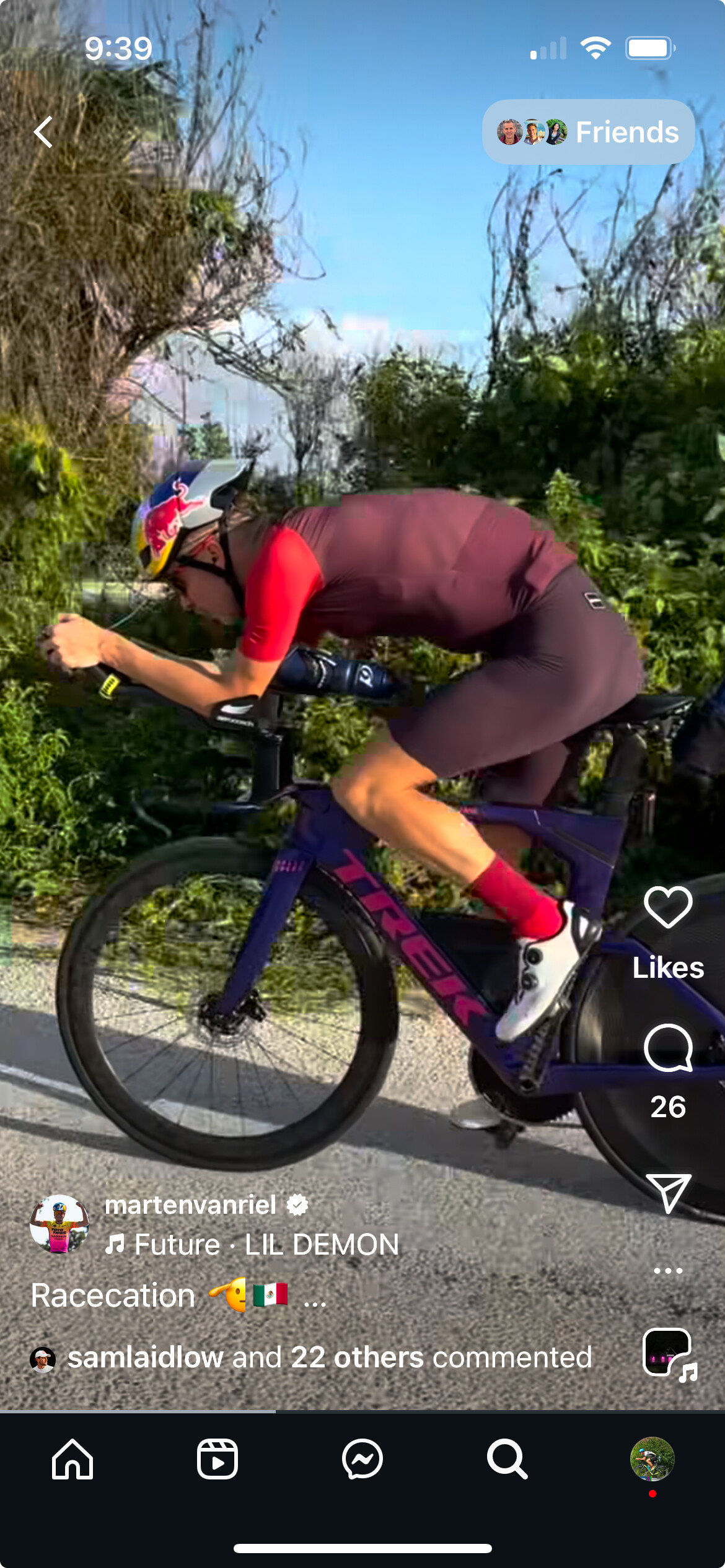

Question ![]()
Lisa Becharas : her elbows seem well ahead of the back of the pads and look at the way she grips.
Is this OK ?
Normal ?
Any insight
She looks a bit better in the pic on her insta
Noteworthy that she says ‘Next year I’ll make sure I get a bike fit
Her power numbers suggest she is is a lot slipperier than I would have thought.
I know another athlete that does that with her wrists so was always curious.

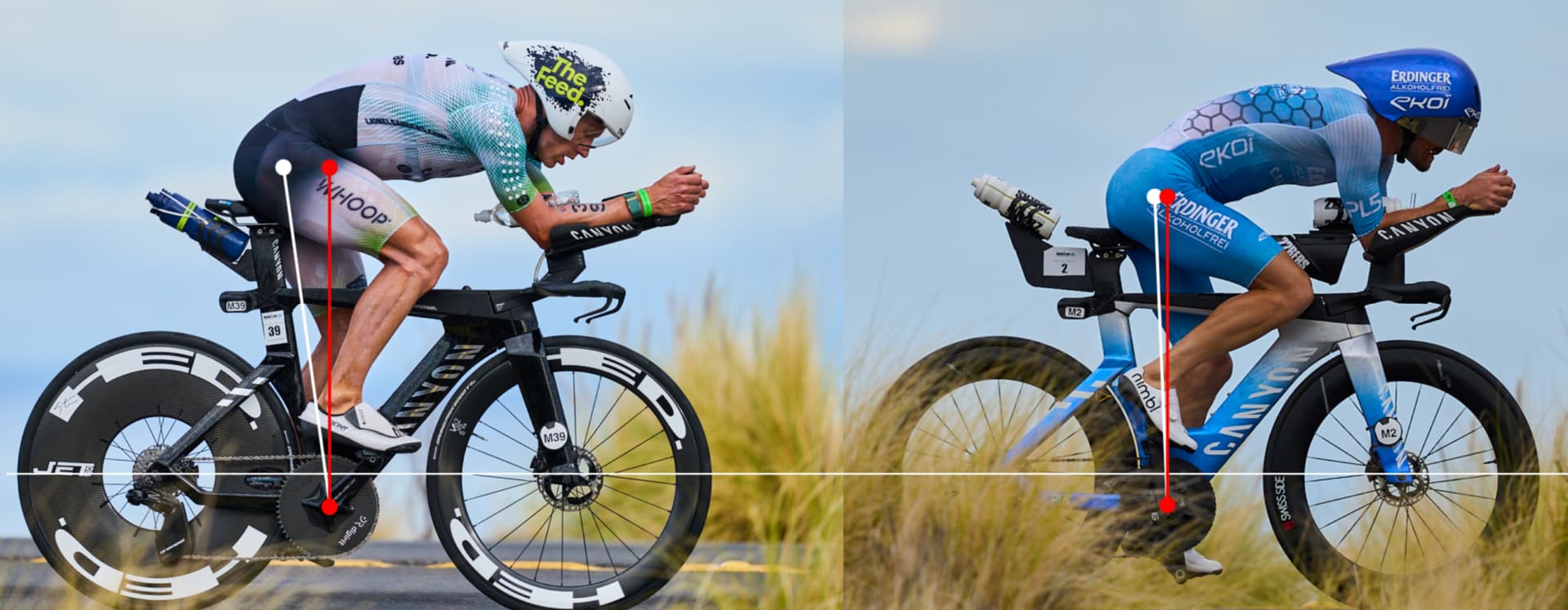

The saddle fore aft-difference between a 75 deg and 82 deg (90 deg if you want) is about 1-4" obviously depending on saddle height. Specialized could easily solve this with a forward seat post design like manufacturers have done for decades (ironically, the Spec Transition comes to mind, but since we are in 2024(5):
Putting these two since they are, roughly, about same height.
It is also a bit due to those FastTT aerobars being on the longish side. The same reason why they come within a couple of weeks with a small and medium size fir smaller males and females.
