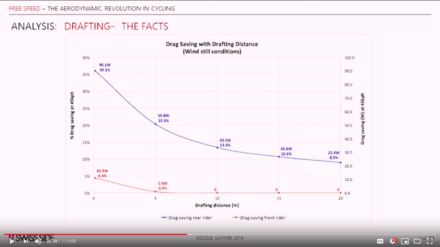

Watching a google talk by Jean-Paul Ballard of SwissSide. Most of it will be familiar to Slowtwitchers, but it’s still interesting. This chart on a CFD simulation he did on drafting for team INEOS I thought was particularly interesting:
https://i.ibb.co/yX6kjjC/draft-drag.png
It’s hard to read in this image, but it shows 40% drag reduction at 0m, 20% at 5m, 13.4% at 10m, 10.6% at 15m and 9% at 20m.
We’ve seen various measurements of this before, but I really like the way he’s presented the data here, and I think the drag reduction he is showing at long distances is a bit more than we’ve seen from other sources. Of course this would be at 0 yaw. Even just a small yaw angle I expect would change this a lot.
And that’s the key. Here’s a situation where the theoretical world of the wind tunnel doesn’t translate that well to the real world. Out on the road, how often is there zero crosswind? Any crosswind is going to move the draft vacuum column, as well as dissipate it. A slight 2.5 mph crosswind component means that the draft pocket 12 meters behind a lead cyclist going 24 mph will have moved more than a meter off his/her path. As the following rider, even if you have the space to move left or right, it’s usually quite difficult to find that small draft pocket 12 meters behind a lead rider, much less stay in it as the relative wind direction and velocity are constantly changing. I’m not saying that there’s no real world drafting benefit to be had within the confines of the drafting rules of triathlon. What I am saying is that, on the whole, it’s considerably less than this “worst case scenario” chart suggests.
