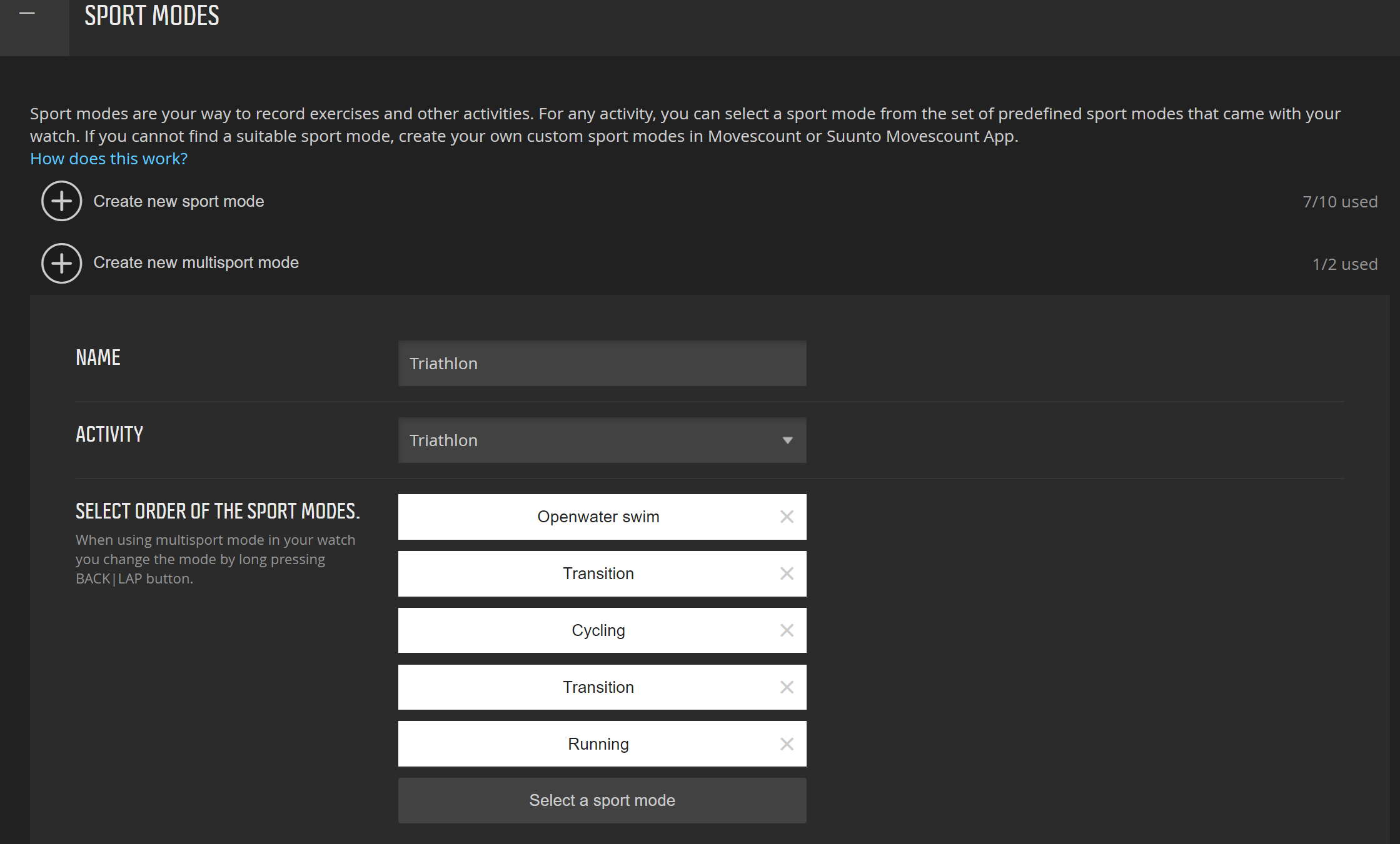

So to setup the triathlon modes.Do the following:
  1. goto: movescount.com → watches
  2. open your watch
  3. open sport modes
  4. select “Create new multisport mode”
  5. select “triathlon” as activity
  6. select sport modes - swimming
  7. select sport mode - cycling
  8. select sport mode - running
  9. click save
    Now you have triathlon mode without transition
if you want transition.
  1. select “create new sport mode”
  2. give it a name “Transition”
  3. click save
To make triathlon mode with transition
  2. open your watch
  3. open sport modes
  7. select sport mode- transition
  8. select sport mode - cycling
    9… select sport mode - tranisition
  9. select sport mode - running
  10. click save
    Now you have triathlon mode with transitions
When doing the triathlon, do long pres with Back / Lap button. It will go to next mode.
below is a screenshot of the sport mode customization tool from movescount
