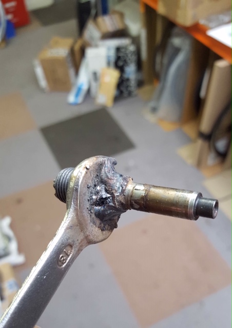

Weld a spanner to the axle like this customer.
