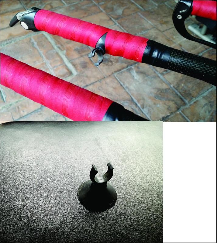

For the magnet I used an aquarium hose director.
Easily available, suction cap on one end that sits well on the aerobar wrapped under the tape.
The “C” clamp rotates so I can dictate the tubes hold.
http://img.photobucket.com/albums/v236/campled/Bike%20Projects/clamp.jpg
