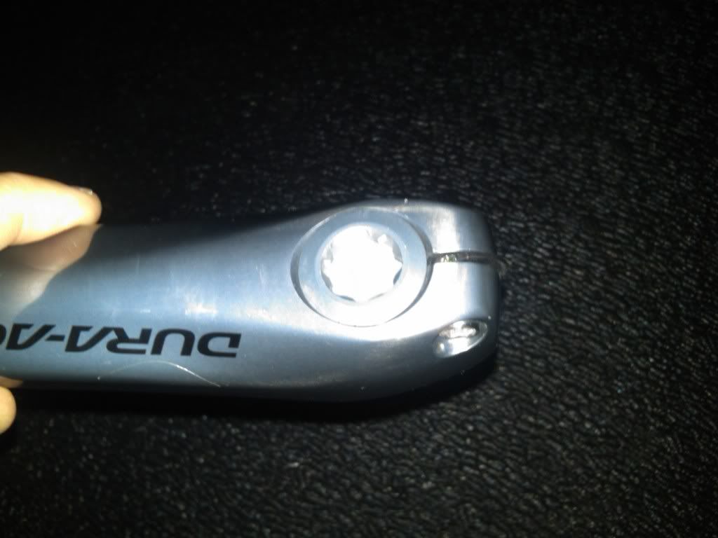

Its a DA 7900 SRM. The bolt is still in the crank arm. I should post of picture of this.
There should be 2, no? Is it broken or stripped any? The only thing I’m thinking is that if this did happen suddenly, then somehow the cap screw material was bad or possibly overtightened and then broke. But, if it broke, then I’d also think that it would shoot out and there’d be nothing left for you to post a picture of. Yet, you have the screw. Weird.

http://i37.photobucket.com/albums/e95/rcntly4298/IMG00005-20100608-2234.jpg
I’m not saying one way or another. I was thinking out loud – so to speak.
Ok, so you have the fixing bolt, the one facing up, and it appears that you have one of the clamping bolts, which is the bolt I was referring to. Is the other one there?
Take the clamping bolt(s) out and see if they’re stripped from cross threading. See if they’re broken or abnormal in some way. Look at the splines on the crank and the slots in the arm – any broken spots?
I’m not coming up with any good answers for you. Are you familiar with your shop? I mean, do you go there often?
Oh, is the stopper plate positioned properly?
