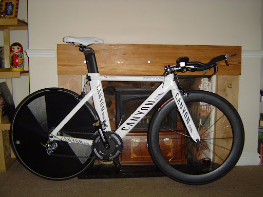

I would listen to jack, he has a fast inexpensive ride. Here is mine, cheap, fast, and aero. I pass plenty of flashy carbon bikes on the race coarse. Id say if you look for used then you could go for under a grand. If you want a new bike then under 2 grand. Besides my powertap(which I had) every thing was under 2 grand because I shopped smart. Here is the link to my bike. http://forum.slowtwitch.com/gforum.cgi?do=post_view_flat;post=2762522;page=1;sb=post_latest_reply;so=ASC;mh=50; A powermeter is great but not necessary to go faster. It taught me to push harder on the bike. Go to ebay for a cheap front aero wheel and buy a wheel cover, youll be all set. You dont need a carbon bike to go fast. My alum bike gets plenty of looks, you have to ride it right though.
http://forum.slowtwitch.com/images/clear_shim.gif
http://lh5.ggpht.com/_B0h82ZGNJCM/S4VpNSD-0sI/AAAAAAAAAtw/0SHHmMw9AF0/s512/DSC00057.JPG
+1! I dont do to bad on an aluminium frame! Buying a cheap carbon frame might not be the answer! M@TTY
