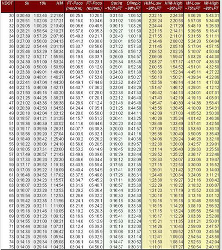

With the caveat of the idea that any measurement system isn’t totally applicable to an individual, let’s just look at your race from a Jack Daniels VDOT table perspective:
10K of 40’ = VDOT of 51.9
  • Easy pace = 4:59 ~ 5:28/k
  • Marathon pace = 4:23 (some say that a good 70.3 run is near one’s marathon pace)
  • Took the liberty of looking at the tracker (not always accurate), you started near 4:30, ended around 5:10/k pace, for an average of near 4:45/k pace. That is sort of right in between that M pace and E pace from Jack Daniels, which in general is a reasonable spot for many people (Jack Daniels’ Marathon pace is more of an “ideal” pace given proper marathon training). Perhaps if you want to sustain that potential M pace you need slightly different, more specific run training.
Doing the same exercise with your open half of 1:31 = VDOT of 50.3
  • Easy pace = 5:06 ~ 5:37
  • Marathon pace = 4:30
  • This half marathon time predicts a 10K time of 41:07, or just a bit slower than your recent PB. So your 40’ 10k could indicate you are a bit more optimized for that shorter, more intense effort, and little less optimized for these longer efforts (hence the durability question).
  • I bet your Olympic/Standard distance would be quite good at the moment.
It’s possible your opening pace of near 4:30 might just have been a little hot (assuming that number is accurate, again I’m going off the tracker). I wonder how you might have felt starting at 4:50 or 4:45/k and holding it steady or potentially being able to increase the pace just slightly over the back half or the last 5k or so.
It’s also possible that temperature played a role too.

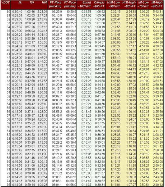

One other interesting resource on potential times: I like this thread from many years ago. The graphic seems to be gone, but I found another copy of it here. I believe I am attributing this table to the correct thread, and @Ale_Martinez, but not positive; also, the tri times are derived from original Jack Daniels VDOT tables. Anyways, your 1:40 is pretty spot on according to an open half time of 1:31. Your 40’ 10k time suggests potential of anywhere from 1:38 to 1:33 high, given the right training for you.
