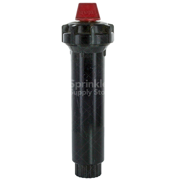

For mine, I didn’t need to dig them up nor did I put on teflon tape. My heads were shaped such that the pipe they screw into fit up inside the head. When you unscrewed the head the pip you exposed was clear of the surrounding dirt. No teflon because a few drips in the dirt wouldn’t be a big issue like a leaky faucet would be. Ours look like this:

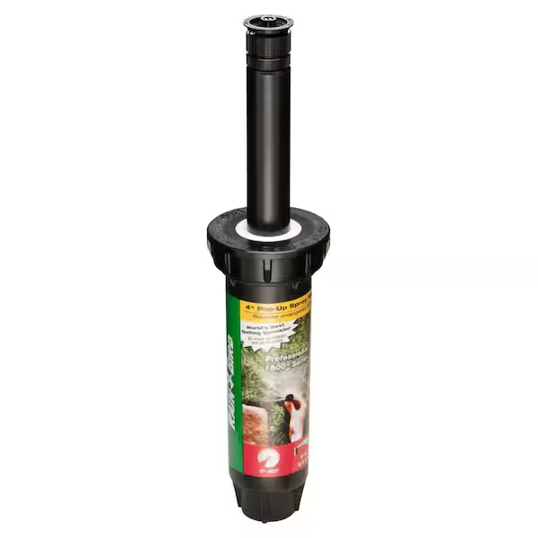

So I need to replace one that’s broken and looks like a fountain
I accept this mission (and will call the company if I have issues)
So just buy that
Unscrew the one in the ground and screw this in?
