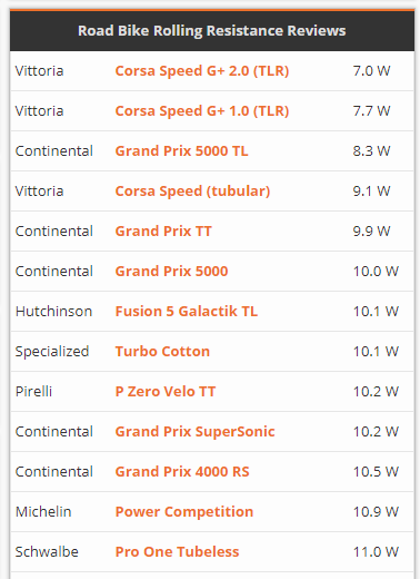

I’m not aware of any rolling resistance data for this tire. A big reason the GP5000TL is the new king is that it tested to within 0.6W watts of the all time fastest Corsa Speed, and even when the new G+ 2.0 Corsa Speed was tested, it was only 1.3W behind. That’s pretty amazing for an “all-around” tire. In fact, I think for many racers there is just no reason to take the extra risk running a Corsa Speed when the GP5000TL is so close (and a much safer choice).
Interesting. Regardless, I personally don’t care about a few watts of rolling resistance in a training tire. Also, I personally had repeated sidewall cuts on the GP4000 that soured me on Continental overall. Perhaps the GP5000 is a bit more reliable, I’m not going to find out.
