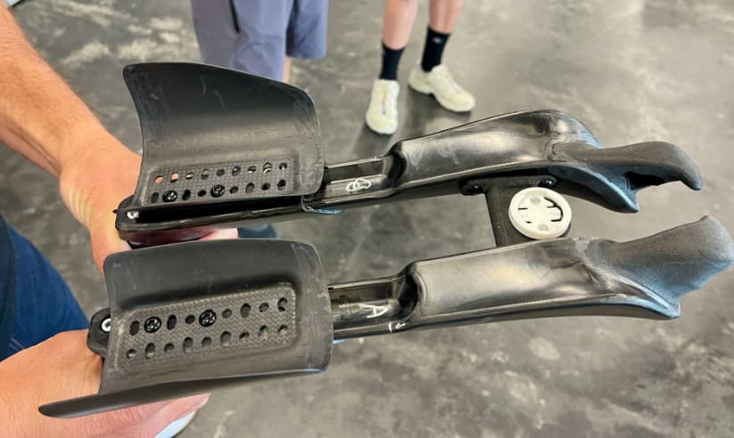

So have Trek licensed that for the SC bars?
Trek is very different, its an extendable extension bar. nothing to do with arm support or full arm support. also its 2 sides connected. etc. The Look patent is specific to full arm support aerobars.
Ah, I know exactly what Trek version was but it was this I hadn’t understood. Thanks.
Enve has very similar extensions. Not sure if they’re paying royalties.

2 very different designs
Enve, 3 piece design. Clamps that holds the aero profiled extension and then a carbon cup attached above it. See pics below, Vrs Look, full arm support design with adjustable length overlapping aero profiles.
