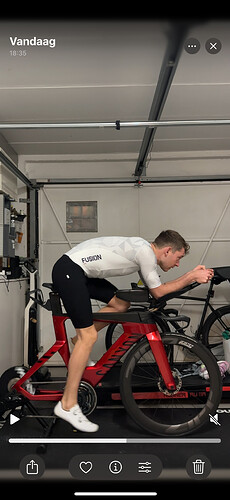

Positional changes after switching to 165mm cranks
Your ankle is incredibly plantarflexed in that picture, and the pedal is again not at the furthest point relative to the saddle.
This is classic confirmation bias at work. All of us are just trying to help - you asked for that help. But you will not listen to anybody who doesn’t support your preconceived belief. You probably won’t even listen to this, since it goes against your belief that you don’t have confirmation bias.
Good luck to you - I’m done trying to help.
Right… I had already lowered my seatheight to test. But ok…
It’s the classic your seat is too high in the video. You could also move forward a touch on the saddle but I’d also want you to move your contact points forward as well to keep everything the same. You could also raise the front end by 1cm. I’d bet a few dollars that would not have an impact on CdA.
Lower the seat 2-2.5cm and see how that feels. If you’re not digging it go up by 5mm and see how that feels at. Shoot more video at each increment and see what that does to your plantar flexion and knee angle.
Some people just ride with some amount of plantar flexion and that’s ok except when it’s due to trying to protect the legs due to saddle height.
It always seems to get a bit confrontational here, and without trying to get in the mix I think you’ve got a quandary - I’m pretty sure everyone here will want to see that ankle flex at the bottom of the pedal stroke disappear, but you’re not looking to make major changes.
In your position I’d contact the team you did the aero testing with and ask how you ended up with such a high saddle, maybe there’s a reason for it, I don’t know we’re remote Internet people and all we know is in your photo. Might be worth thinking how long you’ve been training in that position any and injuries, problems in swimming and running that might be linked - or you might be absolutely fine, not everyone has to be the same.
If you’re running this high seat position due to hip impingement at top of stroke I would suggest changing to short cranks, while keeping seat height unchanged. 165mm are not short enough for triathlon setups in many cases. Many people ride 155 or 160s for triathlon. Otherwise, you should lower the seat and raise the front end with what you’re riding now.

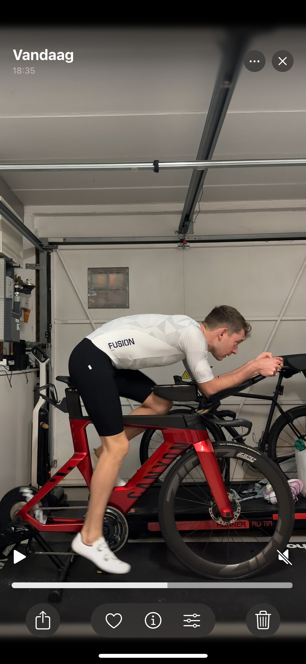

Ok, so I lowered my seat by 1,5cm. And this is the result. Foot is more horizontal than previously. Turbo set tomorrow, let’s see how much more powerful I am :sweat_smile:
The athlete riding the Diamondback looks comfortable enough :sweat_smile:
You still look a bit on the high side of the spectrum to me.
Saddle is still too high.
Still Way too high to my eyes
And the power increase often doesn’t come on dramatically as soon as you make a change
This is much better, and you might be just one of the few that ride a higher saddle hight like myself. If i go lower then my height, which for a lot would be considered high, it feels very uncomfortable. And this is already 15 mm lower then what it used to be but that was really too high like your previous height. But, like you, had no trouble, injury or whatever, actually felt comfortable. It just gave me tight glutes during races, not while training just with racing.
