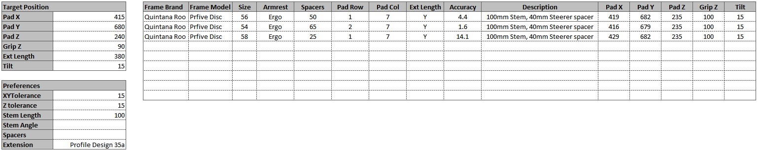

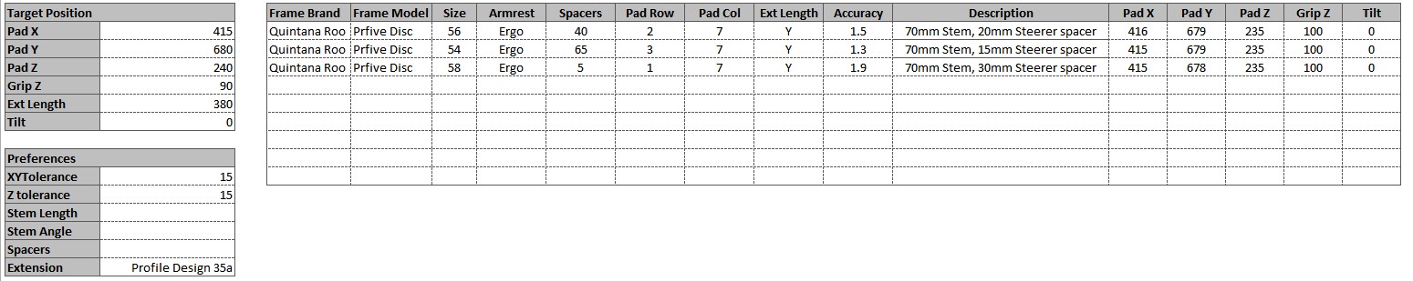

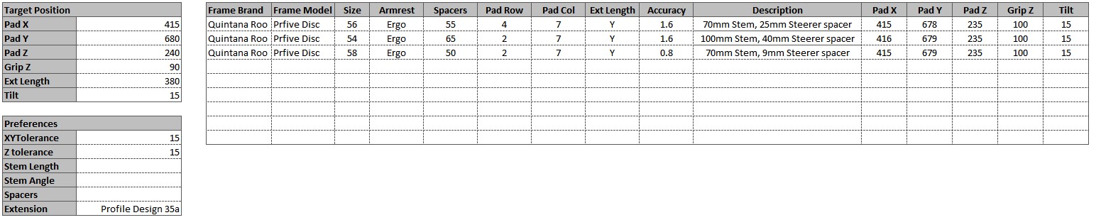

I’ve taken 40mm from pad x to get the measurement to the rear.
This is what we get if we use the standard way of calculating (not accounting for tilt) with a PD Aeria Ultimate bar
But you’ll see that a lot more stack is required on the bars once we account for how much they move when tilted
The max tilt of the AU is 15 Deg - not many integrated bars go to 20.
The impact of tilt is magnified in your case because you need a big frame for the Pad Y and a lot of offset in order to hit X. The higher the pad offset the great the impact of tilting.
Actually, we can take this a step further.
If you have any thought of using the HSF Aeria bottle - it’s much easier to fit on the 100mm stem. But you can see that the required increase in pad offset further increases the stack required.
With that brief delve into aerobar trigonometry done, which of these is the best size for you?
I’d go with the 56 (which is the same as a Cervelo 58 for context) - it has room to go up if needed, but more importantly there is plenty of room to stretch out and go lower over time, without compromising handling. Your position at this point is very conservative - you wouldn’t have any issue adapting over time with the above setup.
