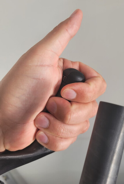

  • I wish the hand grips were longer. My hands are pretty big, and I can only get about 3 1/2 fingers on them or less. I still need to move my SRAM Clic bar end buttons over, and hopefully won’t have an issue pressing them. There’s no way I could make wireless Blips work on the end, as in Slowman’s article on the 43ASC bars. It would be awesome if Profile Design would ship the bars with longer grip sections, maybe with cutting marks, and allow the end user to cut them to length.

For the grips, like most PD products - sized on the basis that I am at the top end of cyclist/triathlete dimensions
Fits exactly with Di2 buttons
SRAM clics didn’t exist when the project was started, just the blipgrip. Grip is definitely too short for clics for most people.
What I’d suggest for AXS is remote blips with a holder
That way you get more length than clics.
As mentioned - future models will get longer grips
Your 2nd picture is exactly how my hands/fingers look on the grips. I think I will design up some short extensions, 3D print them from PETG, and glue them in to get my bar end Clics up to an equivalent Di2 height.
