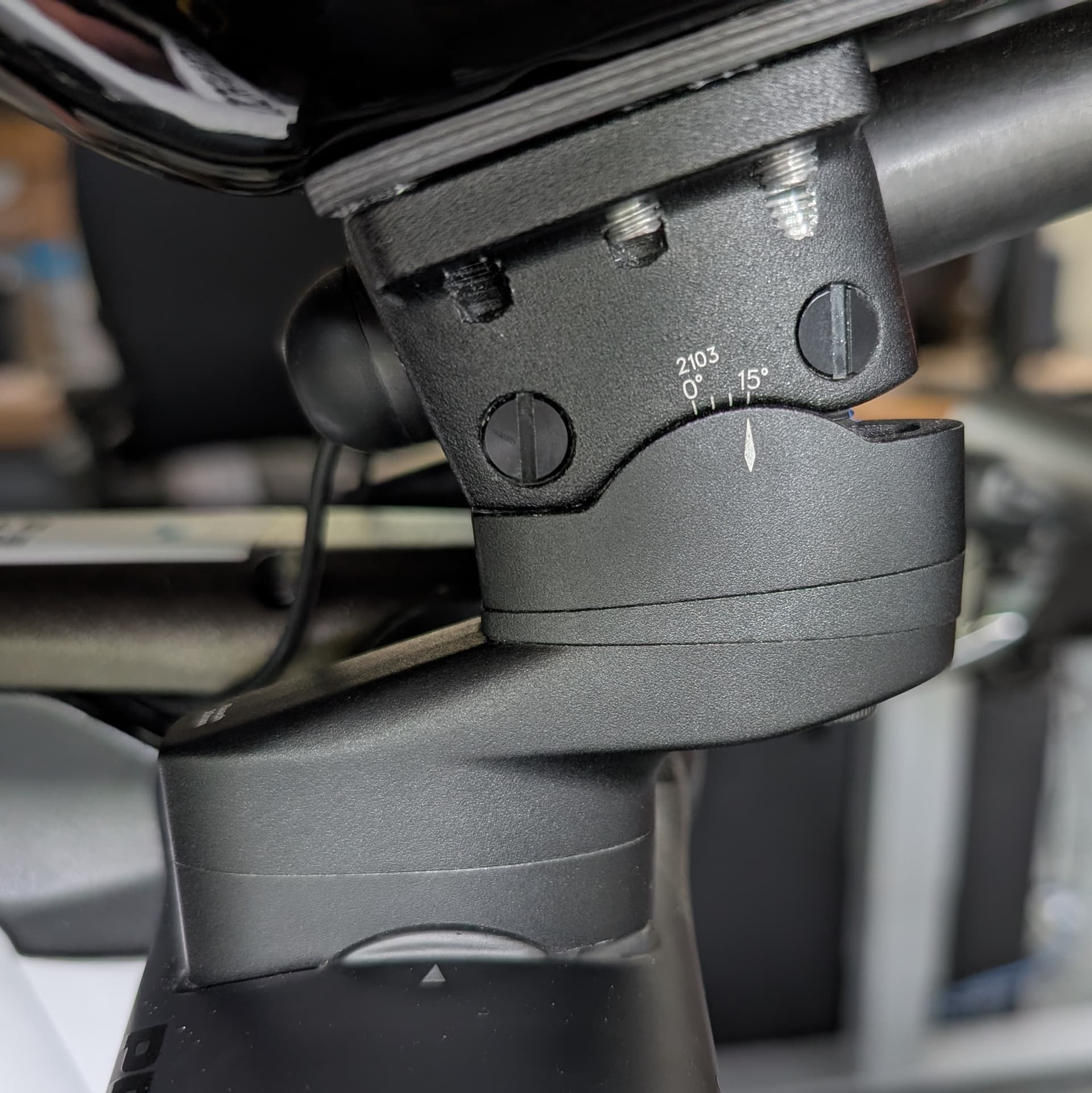

So if i’m looking that that picture right, if i decide to flip the bracket for extra reach, I lose the ability to tilt right?
rearwards full tilt position (excuse the sticker residue)
forwards full tilt position
The aim of this one was to avoid the limitations of the adaptors - the A3 reach extender adds 24mm of stack, the A2 tilt booster adds stack and there are gaps in the tilt range - A2 native is 0-15, booster takes it to 18-27.
Also the A2 moves back a long way when tilted.
So the A3 bracket geometry is designed for minimal x change when tilted, 0-30deg tilt in any config, no other impact from extending the reach. And the barrels don’t fall out while you’re working on it.
Just a collection of refinements that will make the bikes/bars that come with it slightly better.

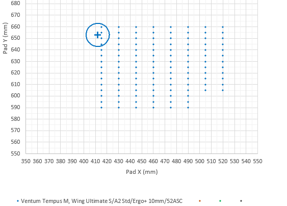

Also for the Tempus - if you have your position measurements (Pad XY and aerobar length) I can calculate which extension length would work.
Thanks for the reply @cyclenutnz.

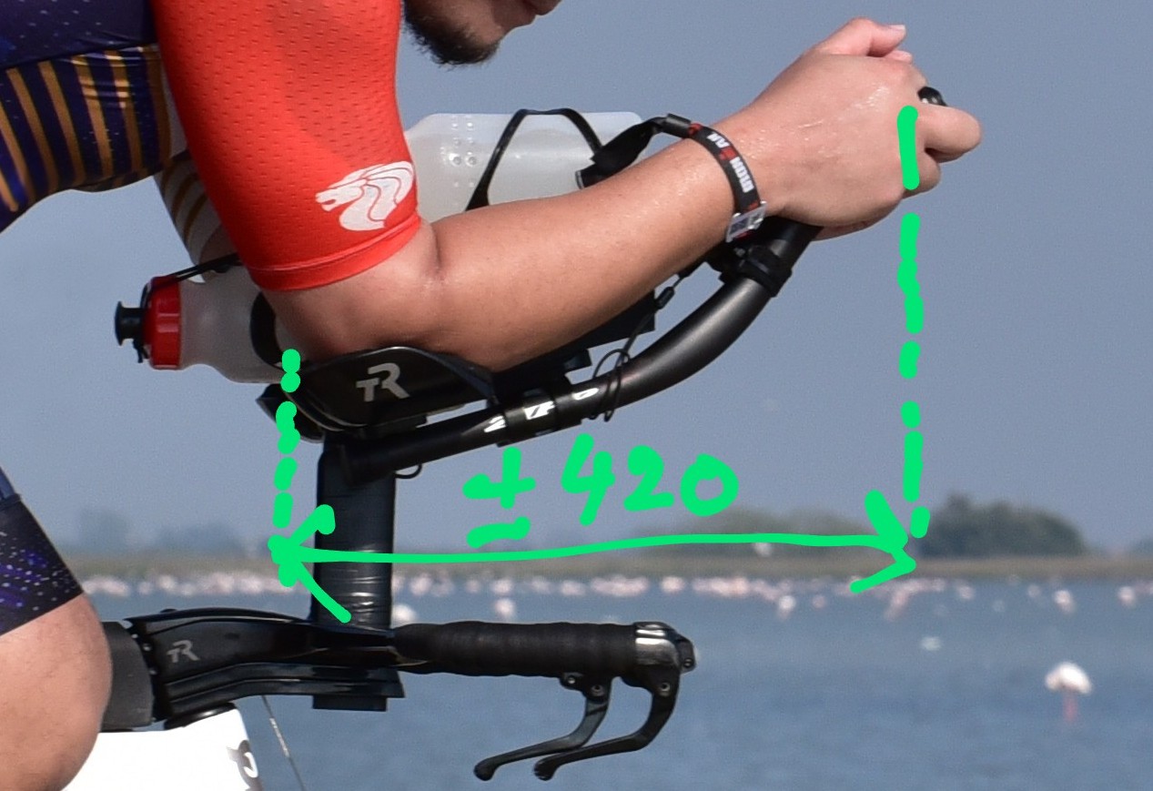

My Pad reach (to back of pad) and stack is tall and narrow at 412mm and 653mm. I’m bit of a short torso inflexible normally.
Measuring my current existing bike aero extension setup on a Tririg Apha One cockpit, the length from the back of the elbow cups to the tip of the aero extension (before Shimano single button shifters) is 420mm.
My guess-timate is that the 400m bar should still fit seeing that the Tempus’s aero bar clamp point is almost below the elbow cups, while my current Tririg aero bar clamp point is so much more forward.

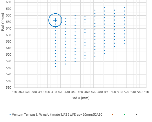

The Tempus is only a marginal match for you
With 0deg tilt you would be on a medium and using 400mm 52ASC
With 15deg tilt a large
Again with 400mm extensions
In both cases you’re at the extreme end of the adjustment range

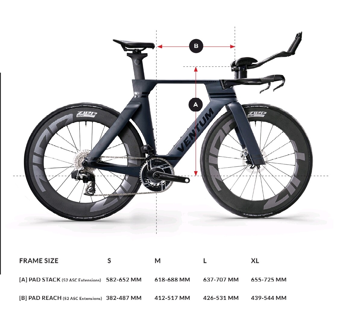

@cyclenutnz, thanks for the further clarification. I have always been on the fit limits of pass frame. Been told my 652mm Stack and 412mm reach is an unusually tall/short combination.
i didn’t actually consider the L size base on this info from Ventum.
The min Pad X of 426mm was beyond my current Pad X of 412mm.
I was only looking at size S and M, which was also more in line with my previous Shiv S size frame and current PRFive 50 size frames.
My dilemma is:
  • S size puts me at the upper limit of the max 652mm stack with no options to go higher in the future if I ever need more comfort. Also the front-center of 562mm is much lower than my current PRfives 584mm which would worsen my toe overlap.
  • M size puts me at the lower limit of the min 412mm reach. I figure in the rarer case I need less reach, I can get longer aftermarket elbow cups. But the 826mm standover height is worrying. (My inseam is only 783mm)

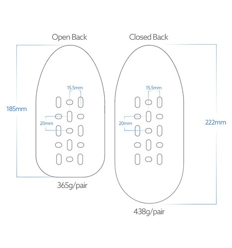

How much armpad do you have behind your elbow?
Your extension length is longer than mine - I am 193cm.
From the numbers it seems like the Pad X situation may be made more difficult by really long pads.
At the moments, none.
I figure with the size M, if I really need to shorten the reach, I can get something like the Tririg Long scoops
These seem to have 10-15mm more space behind as compared to the Ergo+ when mounted in the most rearward position.
