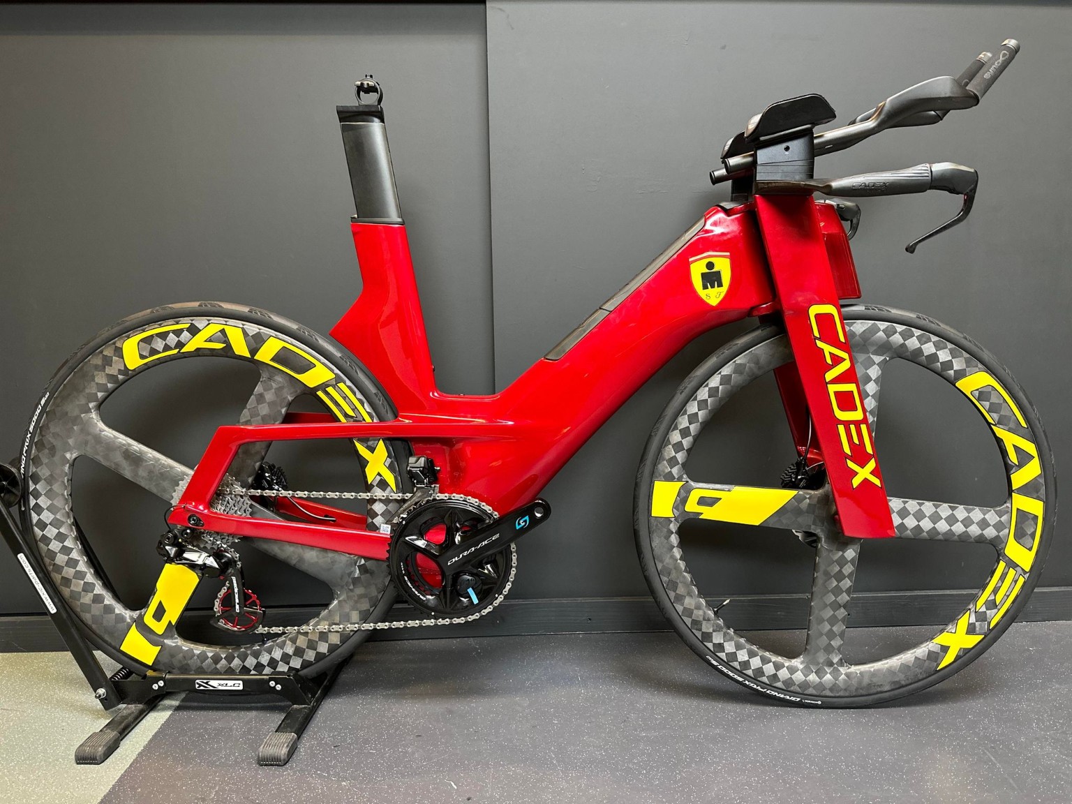

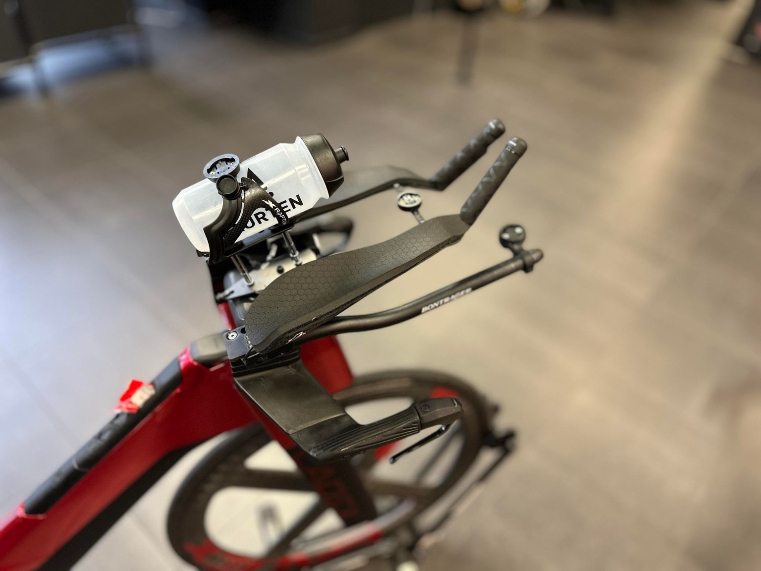

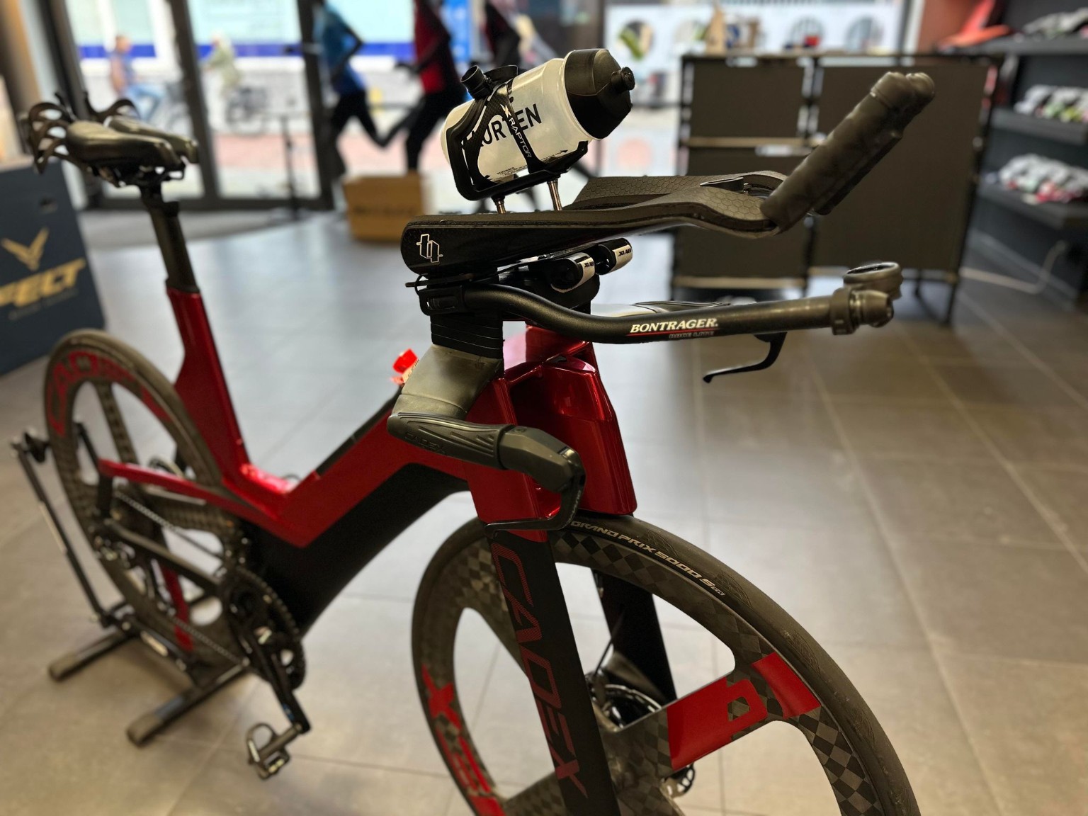

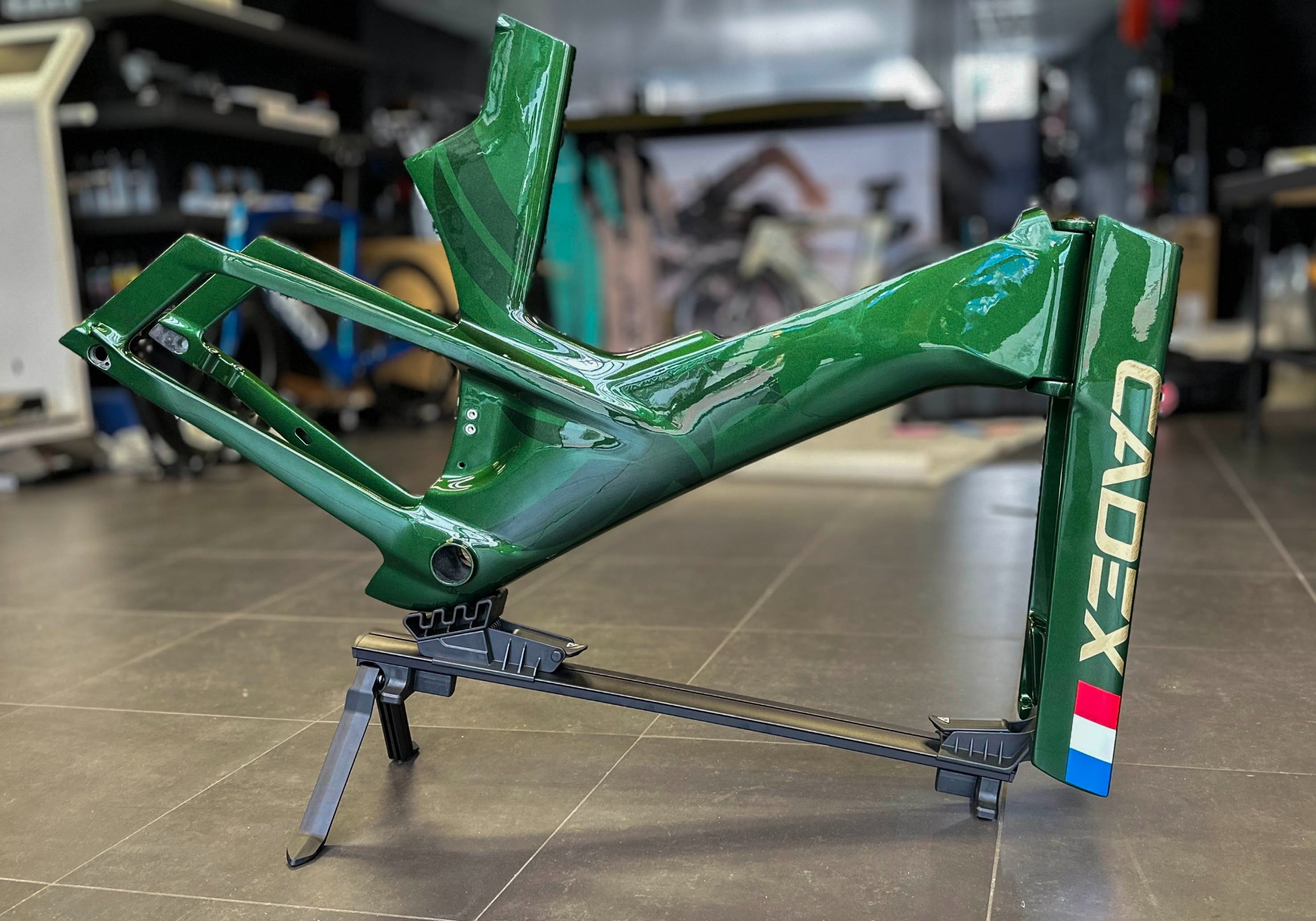

Here is mine, custom painted chrome red :slight_smile:
Do not ‘look’ at that extra extension as I wass too lazy to take it off. I did aerotesting with the aerosensor last Sunday and plan to do some more this week so I just left that on the bike.
Jeroen

Does Cadex paint them custom or you had it done?
Very nice, what extensions are those?
No, it is done here in the Netherlands by Unlimited Colors. Great company that also does al lot of work for the Pro Tour teams. They also did Kristian’s bike and that bike that Porte is now riding.
Jeroen
They are from Spanish company Tetsuo tech, not that expensive at 800 euro’s. Not cheap, but reasonable priced in the full support aerobar extensions and they fit really well.
Jeroen

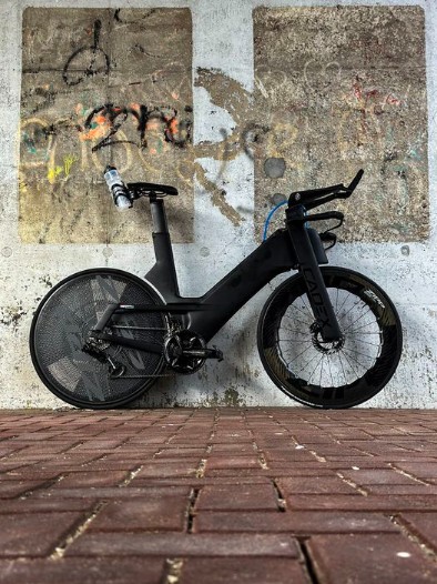

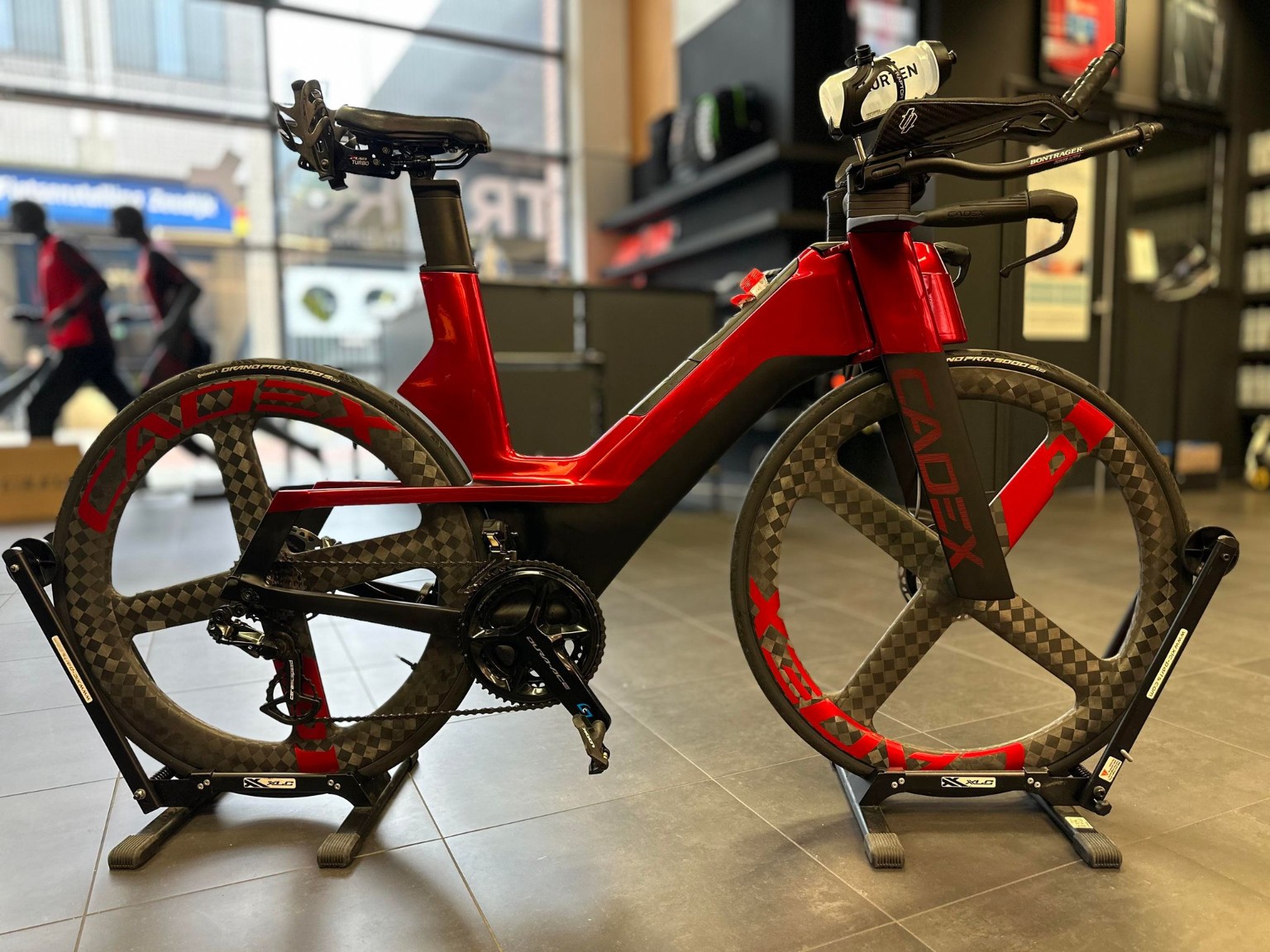

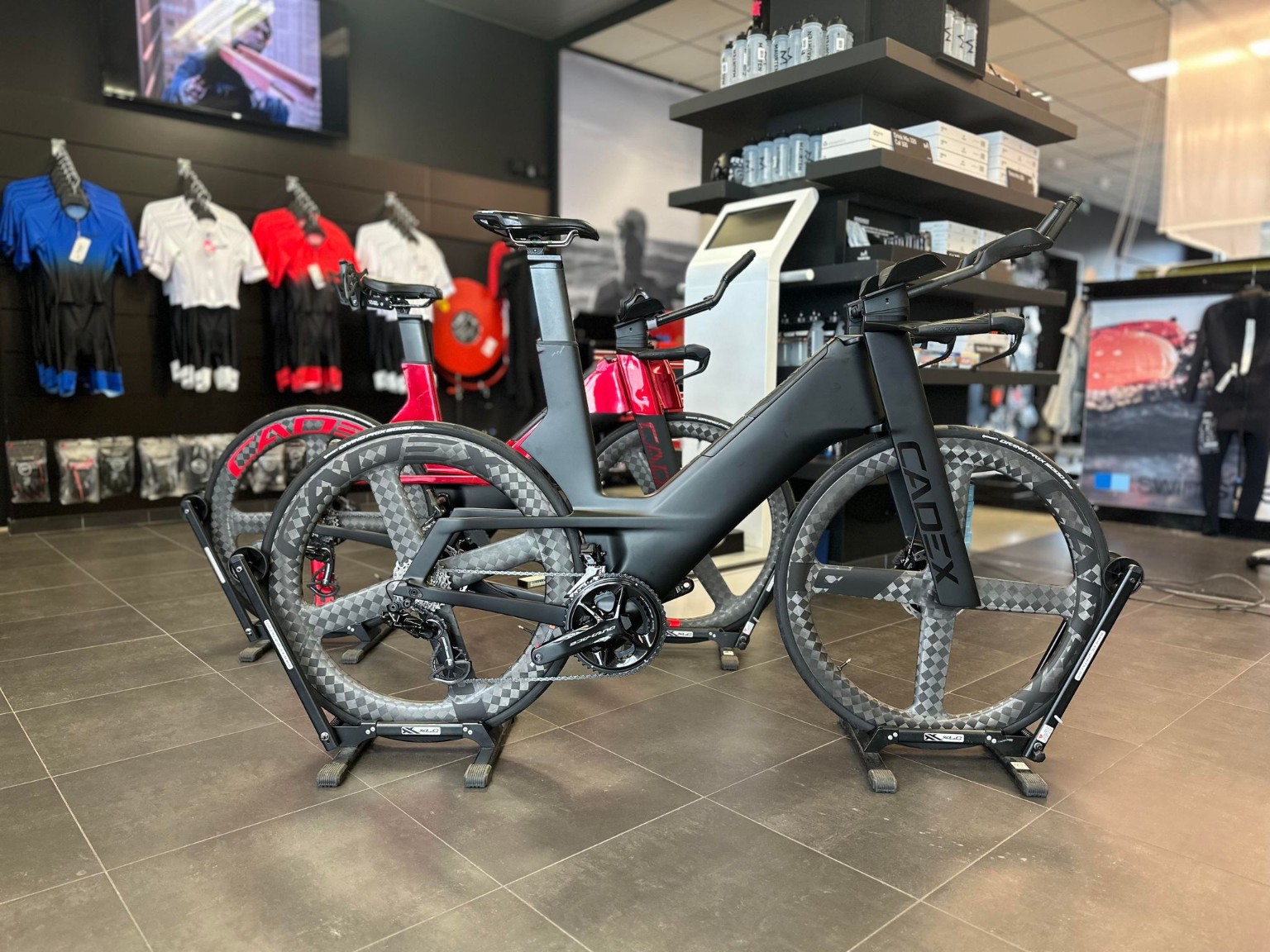

And a few others we built :slight_smile:
