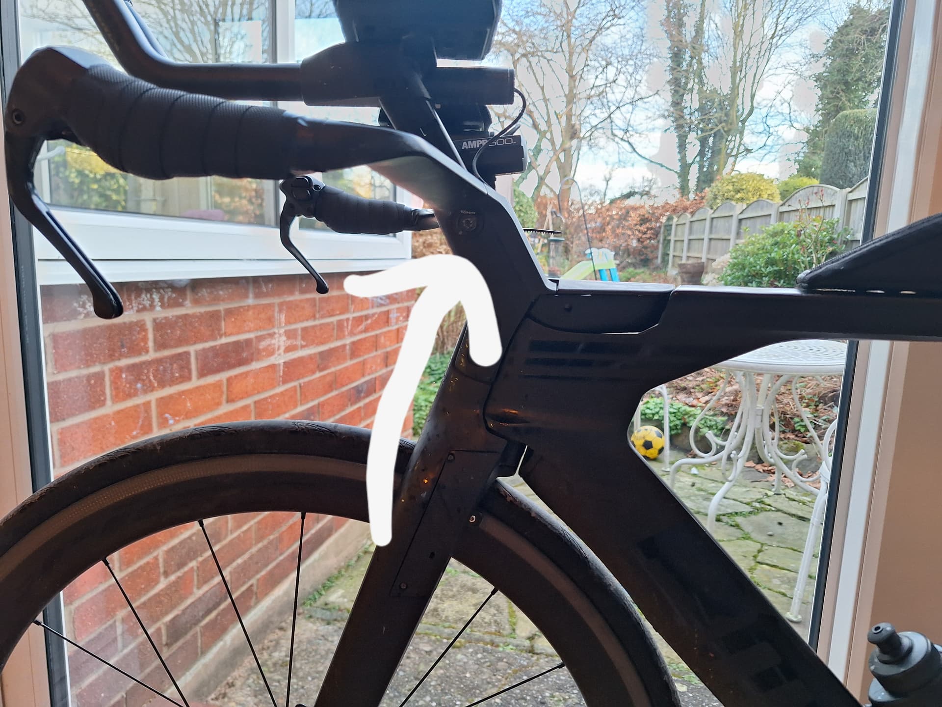

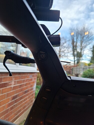

Does anyone know what size bolts these are? Got a 2nd hand Timemachine and theyre threaded on both sides. Ideally i would like replacements before i drill them out.
Thanks in advance.
This looks like V cockpit bridge bolts: BMC TM01 V-Cockpit Bridge Black – BMC Switzerland. I have a flat cockpit so I don’t have this part. But it looks like the cockpit bolt kit bolts are similar: BMC TM01 V / Flat Cockpit Bolt Kit Black – BMC Switzerland and I think I can measure them if needed.
Yes it is a V cockpit. If you could please measure them it would be much appreciated.
The one I found is the lowest bolt on your second picture. Here are the dimensions:
Many thanks for the reply.
I will get some ordered up. Hopefully all 3 of those bolts are identical.
The bike is in good condition but the previous owner has chewed a few of the bolts.
I had the same issue with those bolts on mine. I’m extra cautious with mine since then😁
