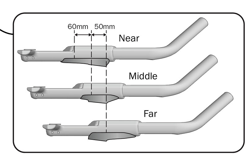

Trek has 3 options for the topper that moves the stock bars either behind or ahead of the front of the tower position. There’s then a fair range of adjustment in terms of bar/pad position.
So in my case with mid topper and the stock (and now FastTT) in a rearward position then, no, certainly no lack of reach for me. In fact I’ve had to go forward a touch as the min reach on Fast TT is longer than I had on the std setup. You can see that in all the stock, the elbow pads are behind the towers by a fair bit.

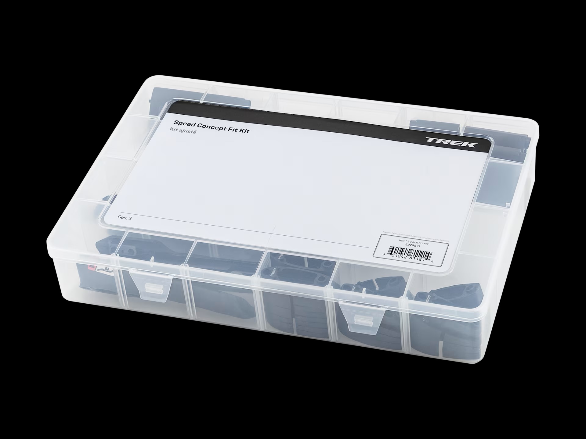

When you order a new SC, you get one set of tower toppers of your choice (near/mid/far), one set of towers (35mm is the std, but you can customize when ordering a P1). In addition you get a set of +7°, a set of -7° wedge spacers, and two sets of 5mm spacers to fine tune. That’s it. If you want to customize further, you’d need to order the parts through Trek, unless you have a good relationship with your Trek store and they are willing to swap out towers (or toppers), and keep your old ones. Trek stores around here usually keep a “fit kit” stocked, that contains every part in every variation.
Note that the bolts are additional to the individual (ie left and right are separate orders).
With my P1 then I deliberately chose the frame size to be midrange with the towers/toppers to keep the cost down if I did change position.
