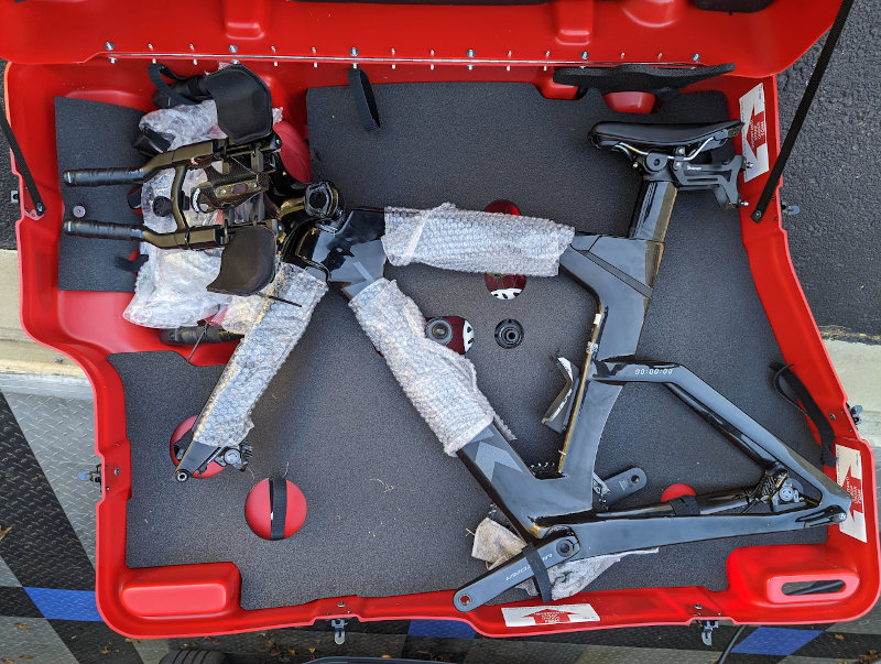

First time flying with my bike, heading to St. George next week. Have a new Bike Box Alan Aero Easyfit (ish) box. The 2022 SLR7 Speed Concept does not fit (bars too wide).
I need to remove the basebar, should be two screws on the side and one down the headtube right?
Anything else I need to know when I take the headset off the SLR? Tips, Tricks, Hints?
I think I’m going to remove the rear derailleur too, have shims in the disc brakes. tie down and pad everything I can.
links to vids appreciated too, I googled around but must not have been searching for the right terms.

So, I just did this to Kona with a 2022 SLR 9 SC in a BB Alan TT box. I think the small or medium might have fit without taking off the base bar, but I needed to do it for the large. It was super smooth. I had to fully remove the one screw on the headtube and the lower two screws on the side, and then I needed to loosen (but not fully remove) the upper two screws on the side. Once all of that was done, the base bar comes off and reinstalls easily. I also removed the rear derailleur, put spacers in the disc brakes, and removed my pedals. And I think that was about that. No muss, no fuss.

I didn’t take any photos, but the BBA box is remarkably simple once you boil it down. There are basically two velcro straps that hold the frame down: one around the chain stay and the other around the fork. Everything else is window dressing and padding you might use to make you feel better. :slight_smile: It took me just a little while to figure it all out on the trip to Kona. Packing up after Kona–exhausted and all–was even easier.

I spent over an hour positioning the bike different ways in the box, with derailleur both on and off, removed rear bottle cage, etc. There was no angle, no configuration, no turning/twisting I could use that either the brake handle or aero pads weren’t obstructing the box from closing.
I’m a small dude 5’5" with a pretty compact aero setup (aero bars had to be cut because reach was too far). If someone here has managed to fit it I’d believe only when I saw the photos - really frustrating but thankfully I do a lot of my own work on my bikes so it’s not a big deal regarding disassembling things- I was just hoping to save a little extra time on both ends.
did you remove the foam padding in the aero extension area? I figured that extra space might be the game changer (the BBA video by SKY actually shows that foam removed) but I’m not willing to risk putting it in there without the padding.
How to break down an SC here - https://www.trekbikes.com/gb/en_GB/speed-concept-fit-travel/
I did not remove any of the padding. I only remove my RD, pedals, and bts cage. As you are closing the box, I do have to slightly move the frame upwards so the one side of the box sits inside the other (I’m particularly talking about the bottom section). If you don’t do this, then the box won’t close as it will collide with your pads or bars.
What crush poll position are you using on the box? There’s only one option that worked for me.
I didn’t change the pole position, didn’t interfere with anything for me (remember, small frame)…
Photo of fits perfectly with headset removed (ugh)
photo attached

I can confirm a large fits in the BBA Easyfit case without taking off basebar. Flew last week to Waco with it. I’m 6’1" with a pretty long reach. Here’s what I did:
Removed rear derailleur Removed pedalsLowered seat a lot (left xlab cage behind it)Added small pieces of foam (the pieces that pop out of the include foam sheets works perfect) between the ends of the case and the brake levers/rear points of frame. I did not need to reduce the reach of the extensions surprisingly.
It was a tight fit lengthwise but no problem with basebar width. From your photo, I had mine rotated a bit more so that the fork was held in place by the lower velcro strap instead of the higher strap. Hope that helps when you pack it up after this weekend. Good luck!
