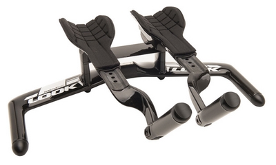

New bars from LOOK (adjustable Speedbar'ish)
The Aergo bars… nice name I guess.
Not quite the custom solution of Speedbar, but the first(?) of what’s likely to come. (haven’t seen price… being LOOK probably not a ton cheaper than the custom options :smiley: )

That has the potential to be really comfortable with the added contact area
Interesting. Wonder what the point price will be on these
I’ve never tried a bar with extra contact area so I guess I can’t really comment, but it just doesn’t seem necessary to me. Regardless, this bar just seems to be trying a little too hard to be different. Interested to read more about it, though.

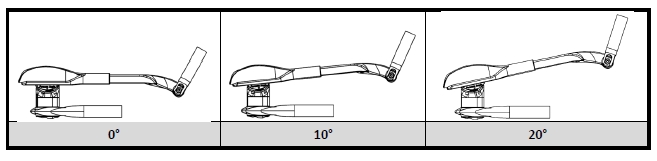

20 degrees of forearm tilt and 70 degrees of grip angle. That’s a hell of a lot of adjustment to play with.
it’s interesting how the extension hinges to let you adjust the grip. Makes sense from LOOK though. Not a bad idea.

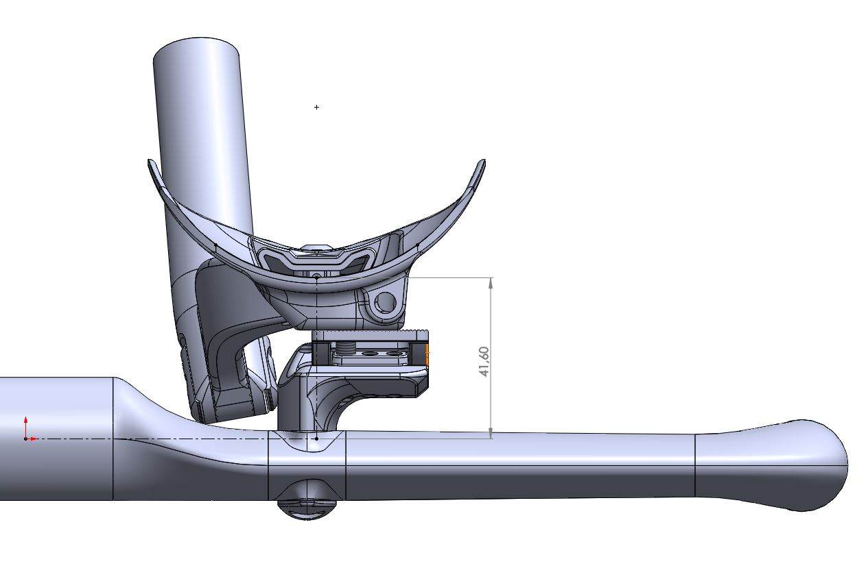

  1. Arm pads stack adjustment (if you use UCI legal bridge or optional triathlon bridge they are equal to a 5mm spacer).

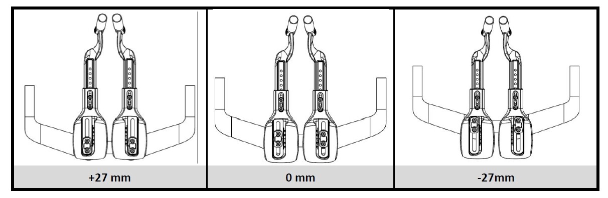

  3. Arm pads reach adjustment (free to adjust from -27mm to +27mm… no holes)
  4. Extensions tilt position from 0 to 20°, again no preset positions

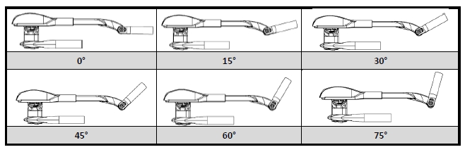

  5. hands grip angle is going to be what you want, no need to swap extensions for a different model, etc.
  1. hands grips angle from straight to inside is very adjustable too

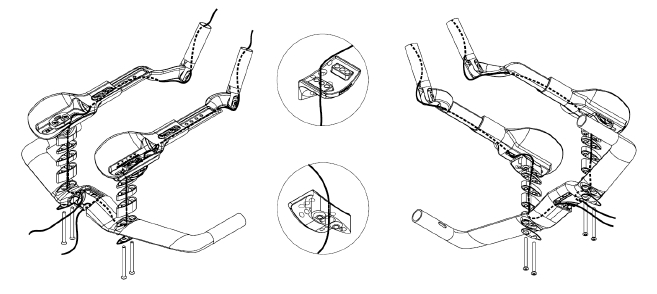

Do you have any drawings showing the cable routing for the 31.8 road version?

For the brakes housings : inside the stem directly on 796 base bar, at the back of the bar on 31.8 road/TT base bar.
