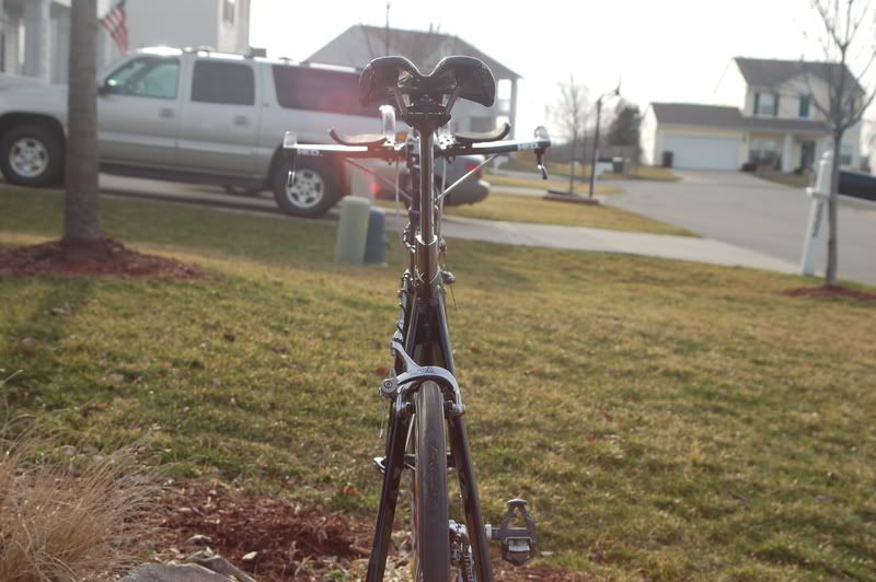

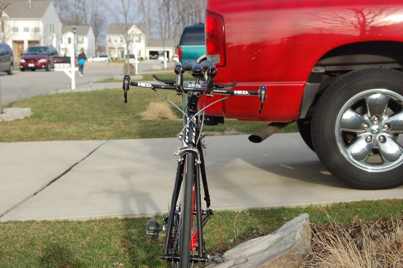

Finally got this built up and threw it outside for a quick ride and pics. 08 Fuji Aloha, 54cm. Made a 3.5cm headtube drop from the last bike, so the stem is up until I can get stretching and comfortable on it. :stuck_out_tongue: It seems like they made a decent attempt on this bike. 78 degree STA, 11cm headtube. I’m fairly comfy on it as is, but will be working on getting lower. I feel like I can easily go lower in the front, but 10-20 minutes in, my shoulders begin to ache, so I’m going to have to ease into it.
Sorry the pic is kinda busy with the foliage.
http://i5.photobucket.com/albums/y163/cslone/DSC_3614.jpg
http://i5.photobucket.com/albums/y163/cslone/DSC_3619.jpg

Very nice setup, I wasn’t expecting to see a Fuji when I open up your thread, shit looks clean…love to see different pimp builds on this forum.
THat looks nice, too bad it is a fuji.

That’s the Fuji 1.0, correct? I have never ridden one, but, I recommended it to a couple people on my tri team based on the reviews I had read. Great write-ups on weight and ride quality. Plus, I like the looks. Yours looks great with those wheels.

I’m a Cervelo fan since getting my r2.5 back in 2004 but that doesn’t stop me appreciating other brands of bike. I think that is one of the nicest looking builds I have seen on the site. It’s looks cohesive as if all of the parts were designed to be together, many of the so-called “uberbuilds” look like an explosion in a paint factory as manufacturers colour schemes clash with each other.
Well done on a well thought out build.

10-20 minutes in, my shoulders begin to ache, so I’m going to have to ease into it…
IMO this may be due to the fact your saddle is tilting down somewhat, from the picture it doesn’t look level with the top tub. This causes you to slip down the saddle and you end up supporting your body weight with your shoulders and upper arms, thus causing the ache.
Try levelling the saddle and then drop it a few mm (about 3-4, I’d say) and see what kind of difference that makes.

Very nice looking ride. Well done. How do you like the 90’s? Any issues with handling?

I saw that once I looked at the pic. On the trainer, it looks more level, so I’m thinking my front wheel was slightly higher. With the nose down, I may be sliding forward and putting more pressure on the shoulders.

I like them so far. I haven’t been out on them a ton, but rode around yesterday in 40 mph wind gusts with no issues.
