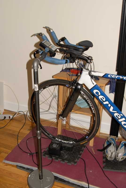

I used the Computrainer Platform instructions as my guide (http://www.computrainer.com/dnloads/CITTplatform.PDF) and went to Home Depot to get some pipes.
Computrainer’s instructions call for:
  • 3 feet 3/4 inch copper tubing
  • 3/4" 90 degree elbow
  • 3/4" copper cap
  • 3/4" Copper Pipe Flange
I made the following modications:
  • 2 x 18" 3/4 inch black steel tubing + 1 3/4" coupler to join the 2 sections
  • 3/4" 90 degree black steel elbow
  • 3/4" black steel flange
  • 5" black steel tube
Total + Tax = $12.61
No tools necessary and total assembly time was about 60 seconds.
I used 2x18" sections so that I could change the height down the road if necessary. 1 x 36" section will save you a buck.
I also didn’t like Computrainer’s instructions to cut the pipe and use a stubby 1" section for the handlebar mount. I used a 5" section of pipe. 3" probably would have been sufficient.
Oh, one major issue you’ll have to address is that the instructions assume you’re going to screw it down to your platform (which I didn’t build). I just happened to have 2 x 10lb weights that i wasn’t using and they fit perfectly around the 3/4" tubing. So you’ll have to figure out some way to make sure it doesn’t tip over.
Photos:
http://i51.photobucket.com/albums/f351/owen_meany/D200_2008_02_14_1575.jpg
http://i51.photobucket.com/albums/f351/owen_meany/D200_2008_02_14_1576.jpg
