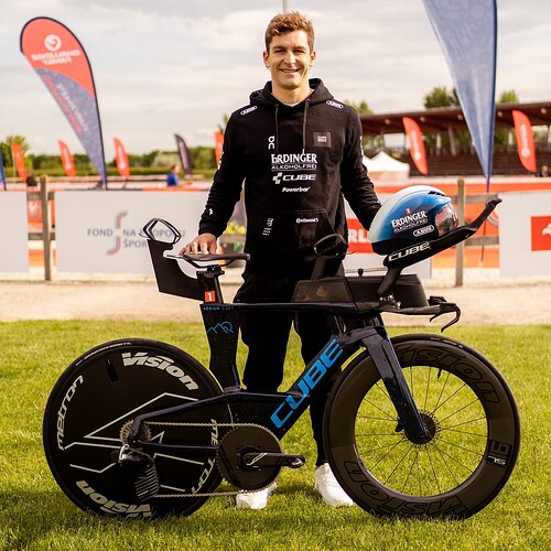

This was Frederic Funk 3 weeks ago. Not as tall but I guess it could have been!

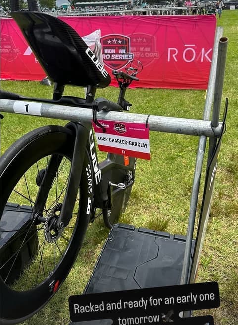

So where would you draw the line if, with every year this mono bar extends further and further towards a nose cone shape.
Extended the sides where it says Cube little by little. Eventually they extend back to the biceps. It’s pretty much a motorbike nose fairing at that point. Are we still ok with that?
There are logical limits, though, to where it stops being “innovation” and becomes something else entirely.
We’ve had reasonable limits on, say, the thickness of wetsuits. We don’t allow disc wheels in Kona. Recumbent bikes are banned. I think there are places where we can say “OK, this stretches beyond any reasonable interpretation of the spirit of our ruleset” and still be well within the innovative umbrella here.
