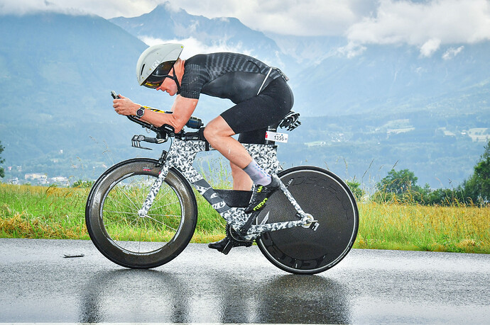

This is my present position:

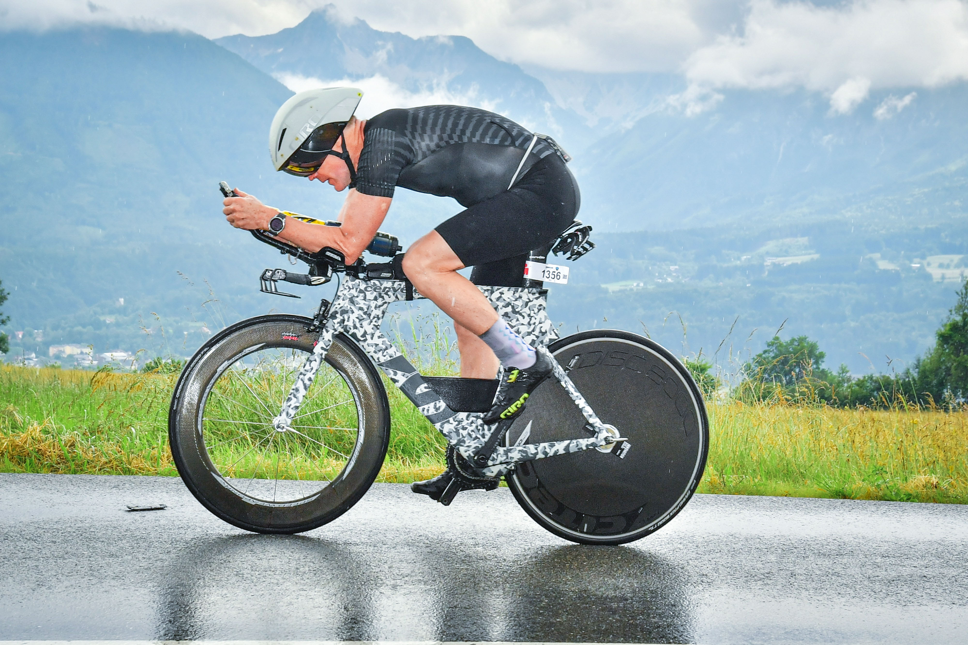

This is the new position:
Since the bike seems pretty adjustable, I can of course make the arm pad drop greater again if I like.
Your position looks pretty good but also falls in line with the standard triathlon thing where it’s set up a lot like a road bike with clip ons. The fitter is 100% on the right track with hip position.
I like to imagine tri/TT fit as taking a road bike hoods/drops position and rotating it forward around the bottom bracket. So your hips move from 1:00 to 12:00, shoulders move from 11:00 to 10:15. The actual angles should stay roughly the same, it’s all just rotated forward.
A lot of people see the low position and try to emulate that by lowering their bars with no other changes, leading to a less than ideal hip extension angle (closed, as some might say). Rotating forward places a lot of weight on your shoulders/front end, but that’s more easily trainable than pedaling with an acute hip angle.
The new position looks better in the hips but very upright, it may be an illusion of your head angle tho.
Yes the picture on the fitter machine was made when I put my head upright sighting, and I remember when the picture on the p5 was made (during a race) I noticed the photographer and put quickly my head down (but like that I cannot see the road).
What is in line with your remark about rotating the body around the bb is that the fit ended up with a saddle angle of -6°. I always used to just have the saddle horizontally
Your saddle height looks on the very high end of the spectrum looking how extended your leg is. Did you do the fit already in mind with buying the Ku through one of their fitters? Or did you decide to buy this model after your bike fit? The reason I ask if it was specifically done with that bike in mind it is weird that the fitter not put on either the Zipp extensions or the FastTT extensions to make sure all details are dialed in perfect.
I also feel you are lacking some reach. Did you tried more reach but went back because it was less comfortable? Especially when you go the ‘modern’ position route. That position is higher and at the same not. Because what you go up also comes down again because of the extra reach. And that measurement you want to have perfect on that bike. You are higher now but look likes you are lacking enough reach.

Yes I measured my saddle is on the fitting machine about 2 cm higher as on my current setup, which I found a bit strange too. Anyway, I do not panic because the bike should be adjustable enough. Maybe my saddle is also too low at the moment. I never went to a fitter before: I made the current setup seen on the picture myself.

Looking at how extended your leg is I would certainly change that in the fit report to how your bike is built. In that Ku the seatpost it is easier to go up then to go down by design.
And your fitter put you up to high for sure.
But I don’t think your saddle was too low on your current bike at all so if you go lower in your saddle back to what you used on current bike it means the rest of your data is also incorrect and should be changed.
The fact that weren’t’ given the opportunity to have the set up immediately right with either the Zipp Vuka’s or the FastTT is just laziness from the fitter or they were just to lazy to invest in the bars. You are buying a great bike for a significant amount of money so better make sure the details are all correct. It is much less adjustable then you are thinking right now. For that kind of money spend you want nothing less then to feel the right extensions, get all the coordinates right and know you like in fit and feel what you are buying.
Go back to the fitter, and check saddle height again, or you can set up the measured saddle height on your current bike and ride it fir a few times, you will not like it. No doubt.
Dial in how it should be with saddle height correct, right type off extensions, right reach and get the new form with data to Ku so your dream bike will not become a nightmare……
