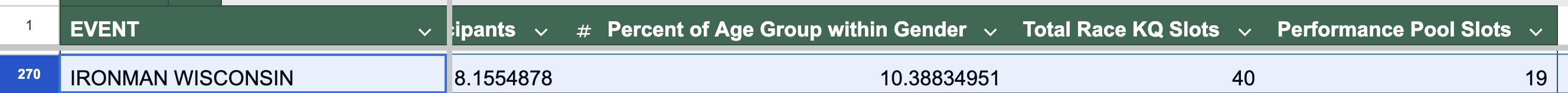

At quick glance something does not seem right here - I just know that i was the final member of the M30-34 AG to get a offered a slot at IM WI and I was 7th in that AG (you have 9)
Also the total number of slots for that race was 40, but you have 47.
For cali you have 64 slots but there was only 55
feel free to cross reference my sheet posted earlier in the thread
I have 55 slots for CA and and 40 slots for Wisconsin.
I fixed another error earlier today but that shouldn’t have affected the slot number.
9 represents the number of people in that age group that would have been offered slots based on their time. If you were 7th in your AG, then your AG ranking wouldn’t matter at all — it would go to the performance pool. 2 others slower than you in the AG may have been eligible to claim one of those slots but did not show up/already had one from a previous race.
I’ll double check on this again though.
Maybe I’m reading it wrong but when you sum column c it’s 47
I can confirm at WI no one lower than 7 in my age group was eligible in the performance piok
finally look at whats happening in more detail
It looks like you are grabbing the top X (55, 40, etc) in the performance pool and assuming they would all be offered the slot. This is not the case - If one of the AG winners is outside the top X then it reduces how deep the pool goes.
In the case of Wisconsin and California there were AG winner that didn’t crack the top 40 or the top 55 respectively in their performance pool ranks. So the pools only offered slots to the people in the top 32 and 46 in the performance pool respectively.

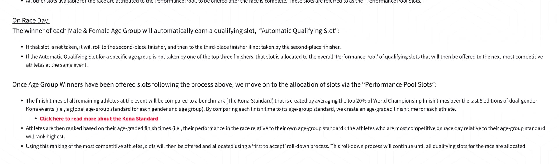

Wait I’m confused — my understanding of the system was that:
  1. Every AG winner gets offered a slot not matter their time
  2. After every AG winner gets offered a slot they go to the performance pool for the remaining slots
    This appears to be what Ironman says on their website:
So I did this:
df['adjusted_time'] = df['Finish Time'] * df['Factor']
df['auto_kq'] = False
#if you win your age group you get a slot
df.loc[df['Age Group Ranking'] == 1, 'auto_kq'] = True
#rank people on their adjusted times for each event
df['rank'] = df.groupby('EVENT')['adjusted_time'].rank(method='first').astype(int)
#if you don't already have a slot (auto_kq == False) and your adjusted time rank is below the total number of slots, you get offered a slot
df.loc[((df['auto_kq'] == False) & (df['rank'] <= df['SLOTS ALLOCATED'])), 'auto_kq'] = True
Is this incorrect?
