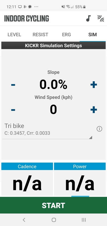

This is the wahoo app. Scroll right from the initial screen to get to this one. See the Level, Resist, Erg and Sim tabs on top - those are the modes I’m talking about.
Where did you find this? the Black Wahoo software/app does not have it. The Wahoo utilities just finds the sensors. Accuracy stinks when riding without software in like ero mode. Rode 250 watt intervals at all 17.3-6 mph. Not accurate.

Black app. After you start the workout swipe left. That’s how you move to the next page…
