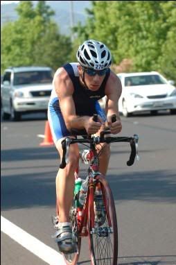

Agree with above, but it looks better than this position:
http://i95.photobucket.com/albums/l138/rafaeldonnay/sjit_2006_01.jpg http://i95.photobucket.com/albums/l138/rafaeldonnay/12228-024-011f.jpg
Alright you Slowtwitch stalker, how the heck did you find me?? haha - I guess I won’t have to “smoke” my head in future pictures.
