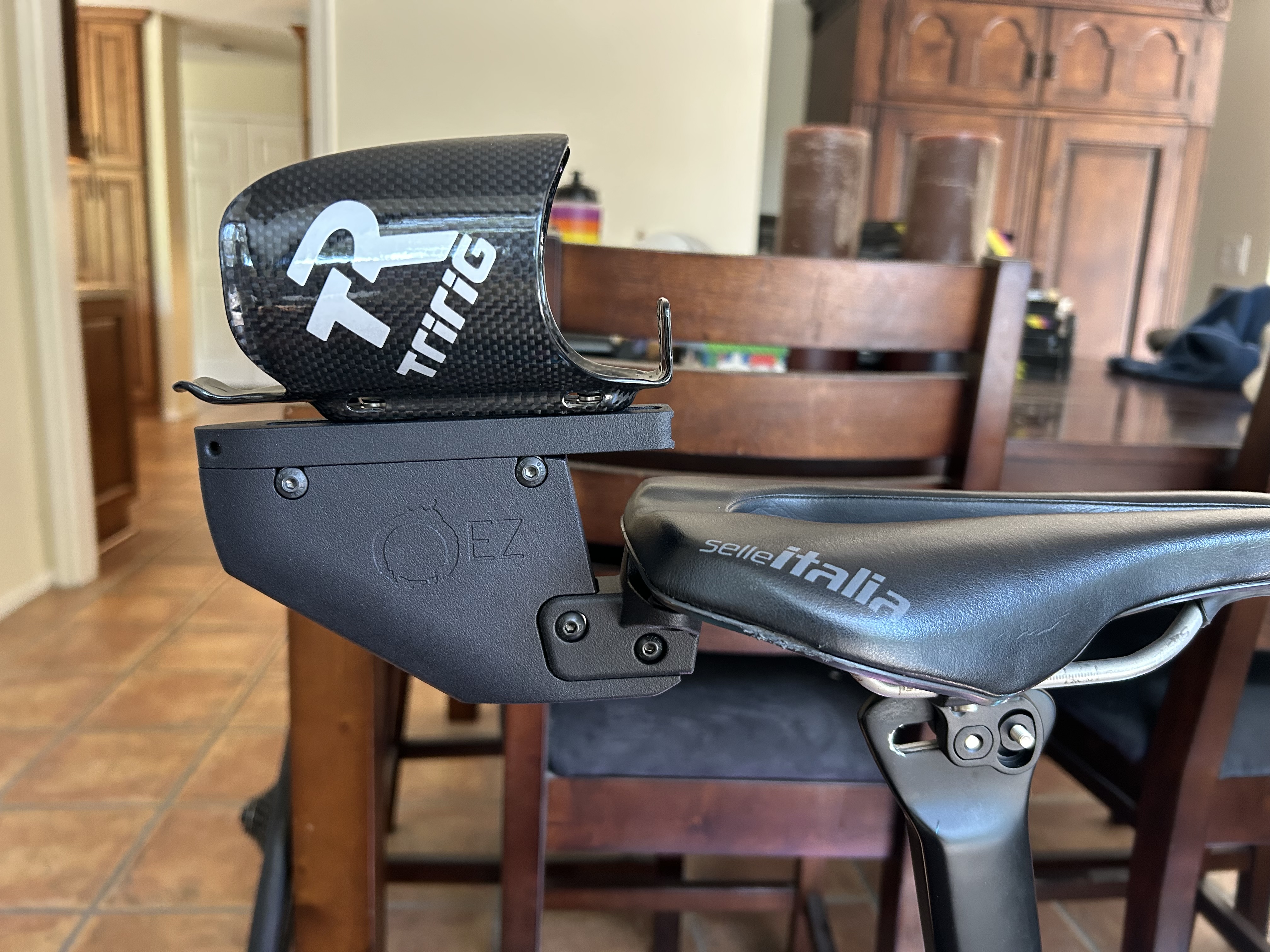

Jim tests the EZGains Hydro

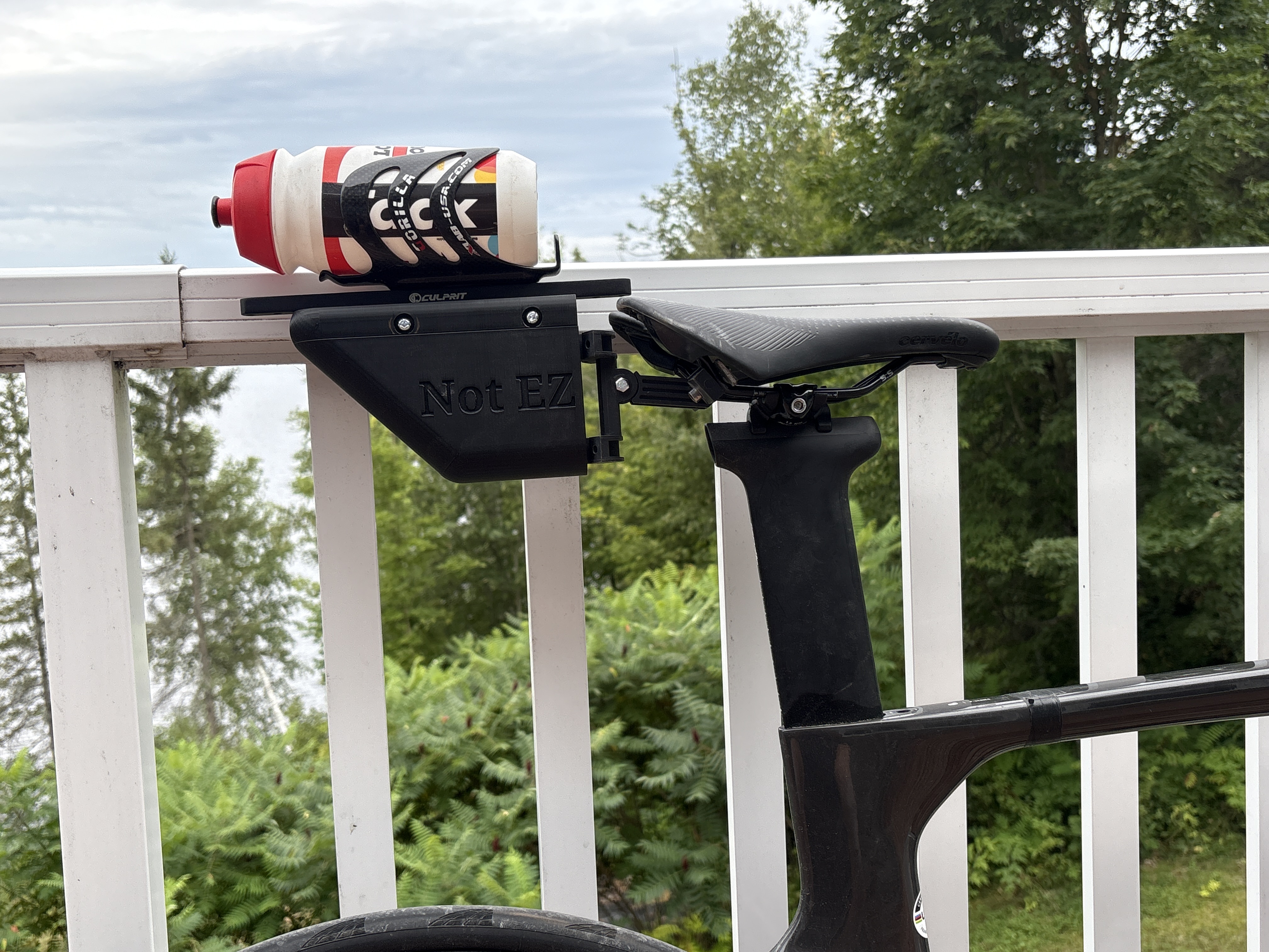

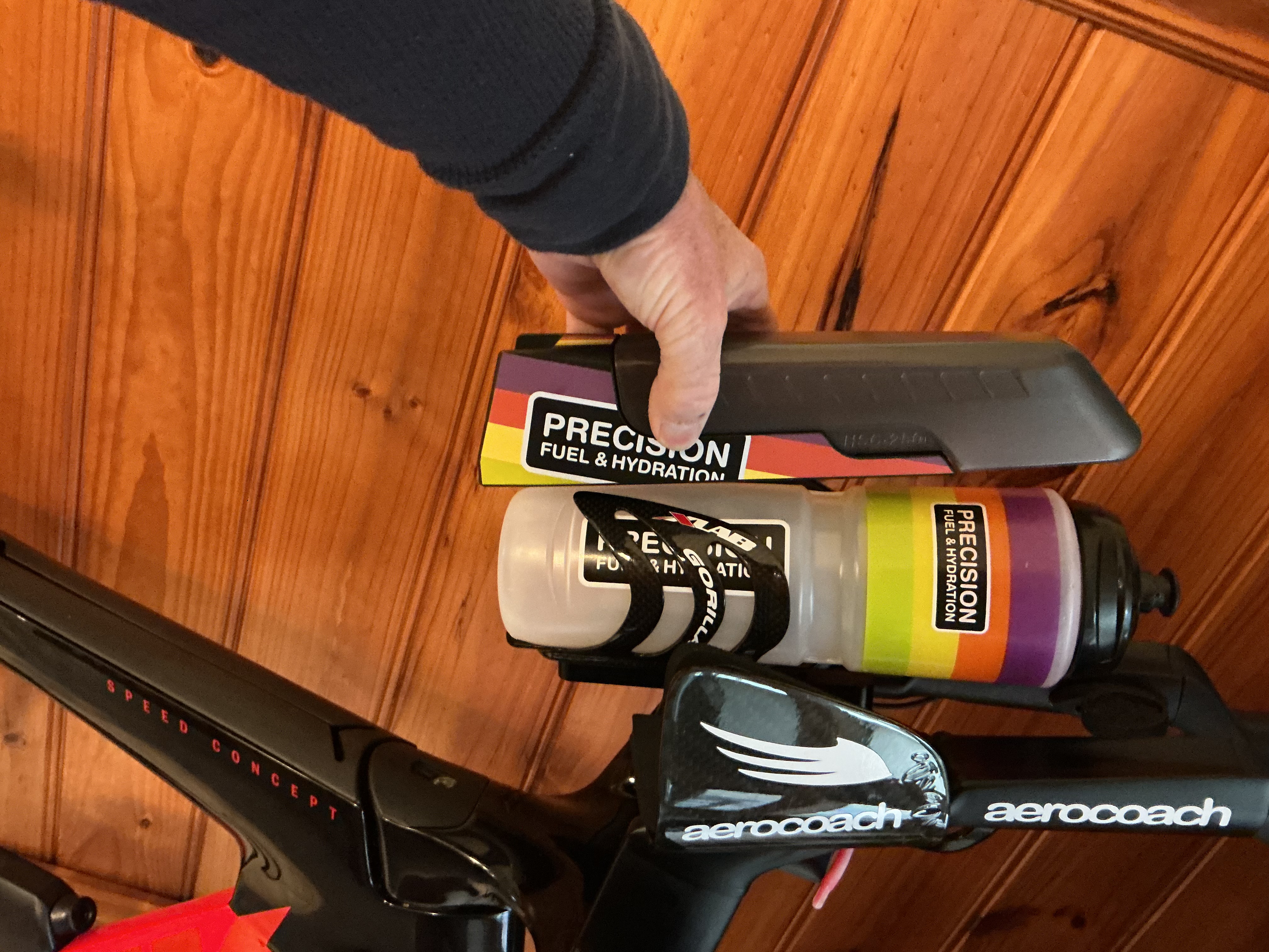

Any ideas how to attach this gel bottle above the BTA bottle ?
Gel Bottle is designed to go here , but not very aero ???
Not sure what else to do with it , as the other 3 biddon holders I have are taken with my fluid/electrolytes
Pretty sure that if you swap side it will be a little bit better

yes you mean swing it around so it faces with the pointy end forward??

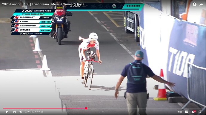

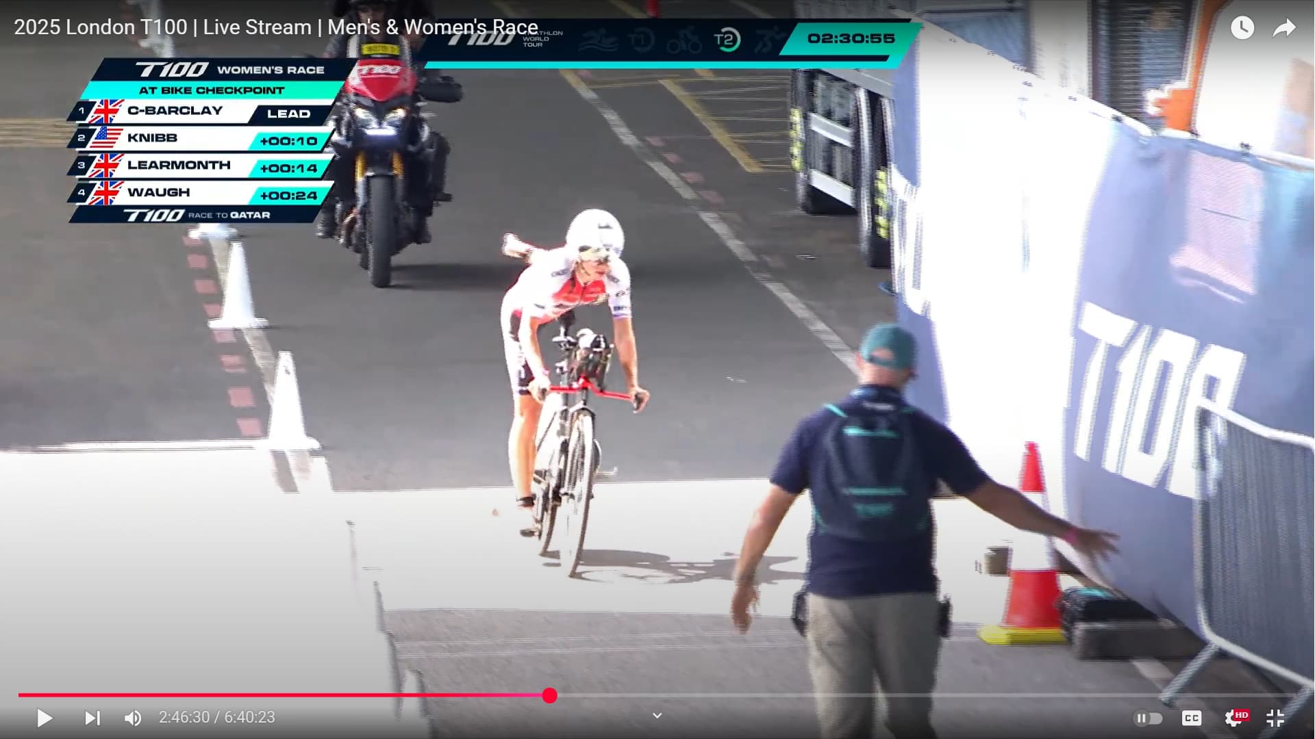

Anybody here raced with the EZGains BTS system yet? Keen to know what the situation is regarding flying mounts/dismounts!

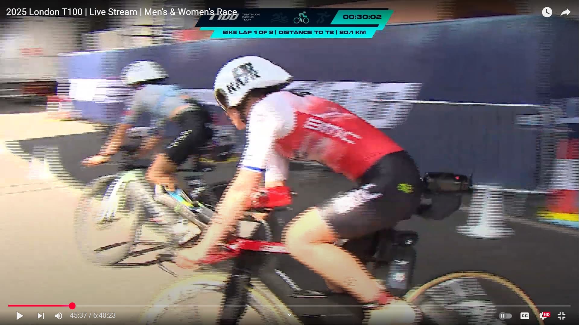

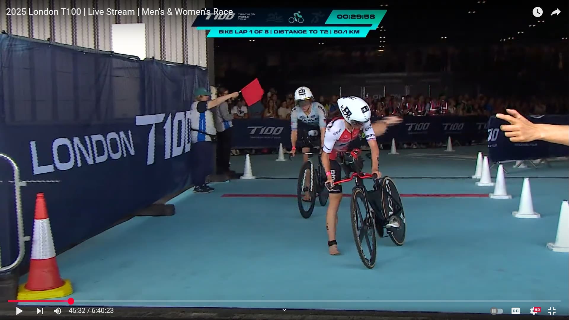

I saw quite a few pros using the system at the T100 London but there wasn’t much coverage of the actual mounts/dismounts.
Is it a no go for anyone without the flexibility of a gymnast? I appreciate the aero gains over race distance outweigh the few seconds you gain from flying mounts/dismounts, but I do find they allow me to keep momentum.

Could possibly use a bottle cage with garmin mount on top (I’m thinking ProfileDesign HSF BTA style) and glue a 3d printed garmin attachment on the bottom of the gel flask?
(bit of a hack, but since it doesn’t need to be removed while riding that may work — and may need to make it look clean to pass by officials)

Can you just toss the gel bottle holder, remove the trek bento box, and use a strip of velcro tape to hold the gel bottle inside the top tube?
-Scott
@WiScott
Yes I have done that , the bottle actually fits in nicely
Its snug and may rub holes through the bottle on the sharp edges of the frame
But this is the best idea I think
If I can find a more narrow aero bottle , we could possibly make a bracket that would go inside the bento box hole for it to attach to
Be good to find a aero bottle that’s , small and narrow but doesn’t leak
I’ve done one race with it, and practiced mounting/dismounting beforehand. With a foot on the ground, I can’t swing a leg over the top of my two bottles. But if I have my shoes clipped into the pedals, I can step on a shoe, rotate that pedal to the 6 o’clock position, then swing my other leg over easily. I do the same in reverse to dismount. I used to sort of leap frog onto the saddle before placing my feet onto (or into) my shoes. That I can’t do anymore.
The Profile Design aero bottle is slightly wider and I don’t think would fit into the frame area with the bento box removed. I think the Elite aero bottle might be thinner but mine has gone missing and I can’t verify.
It would be nice to have a printed insert that is recessed into the frame a bit. It could catch any leakage and prevent it from gunking up your headset bearings. I may actually see if I can have that idea printed up by a friend.
This seems to jibe with what the pros were doing. They largely avoided flying mounts with the EZGains, but did flying dismounts.

Cost me $15 to convert an xlab BTS mount I had to something approximating the EZ Gains dual bottle setup. Bought an aluminum dual cage bracket off Amazon and combined it with a 3d printed adapter to get everything horizontal. Looks/works great, but I havent aero tested it yet. Similar comment regarding TRI Rig’s BTA elevator/rail. Really like all the gear I made from a utility standpoint, don’t know if it’s actually faster…
I think I’m in $25.00 for mine.
I would agree, but I spent extra $30 on a 3d printed riser on mine setup.
Good enough for testing ?
