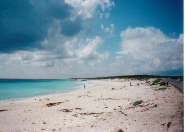

The East coast section, which is as you can see from my snaps, is only 50 feet from the water for 20k south of Mescalitos is totally exposed to the Easterly trades off the ocean.

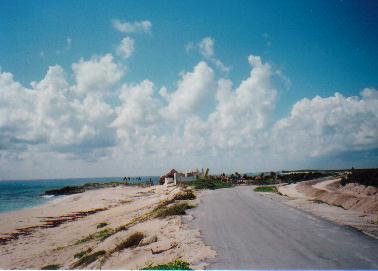

Punta Morenas, 3k s. of Mescalitos
http://www.geoffwhite.ws/images6/poc-puntamorena.jpg

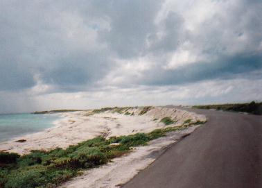

Chen Rio, s. of punta Morenas
http://www.geoffwhite.ws/images6/poc-chenrio.jpg
Playa Bonita, just n. of El Caracol & Bob Marley’s bar
http://www.geoffwhite.ws/images6/poc-playabonita.jpg

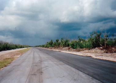

There was new asphalt on over 50% of the course. That was the 30k section from Chankanab on th ewest side to Bob Marleys pub at El Caracol, where the road meets the east coast and turns northwards. Most of the 30k section has some protection from the low trees along the roadside. (see pic below)
http://www.geoffwhite.ws/images6/poc-newhwy.jpg
