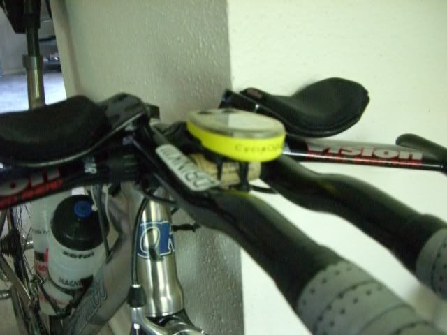

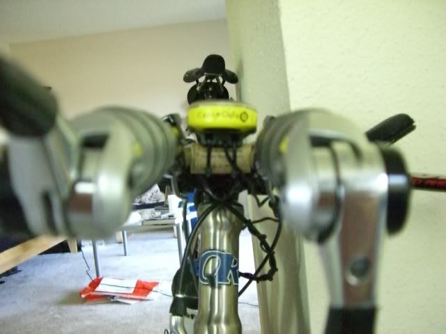

I use one of these
http://www.tri-sports.com/computermount.html
But, for a while I just put the watch band around the stem and base bar at an angle. Worked fine.
sure it’s a PowerTap but it’s not a stretch to say you could do this with the polar… just mount the polar bar mount to the cork… if you are going to use a cork you’ll need to get your bars reeeeeally close. :slight_smile: hey… better aerodynamics :slight_smile:
http://i19.photobucket.com/albums/b182/markavan/CIMG0770.jpg
http://i19.photobucket.com/albums/b182/markavan/CIMG0771.jpg
