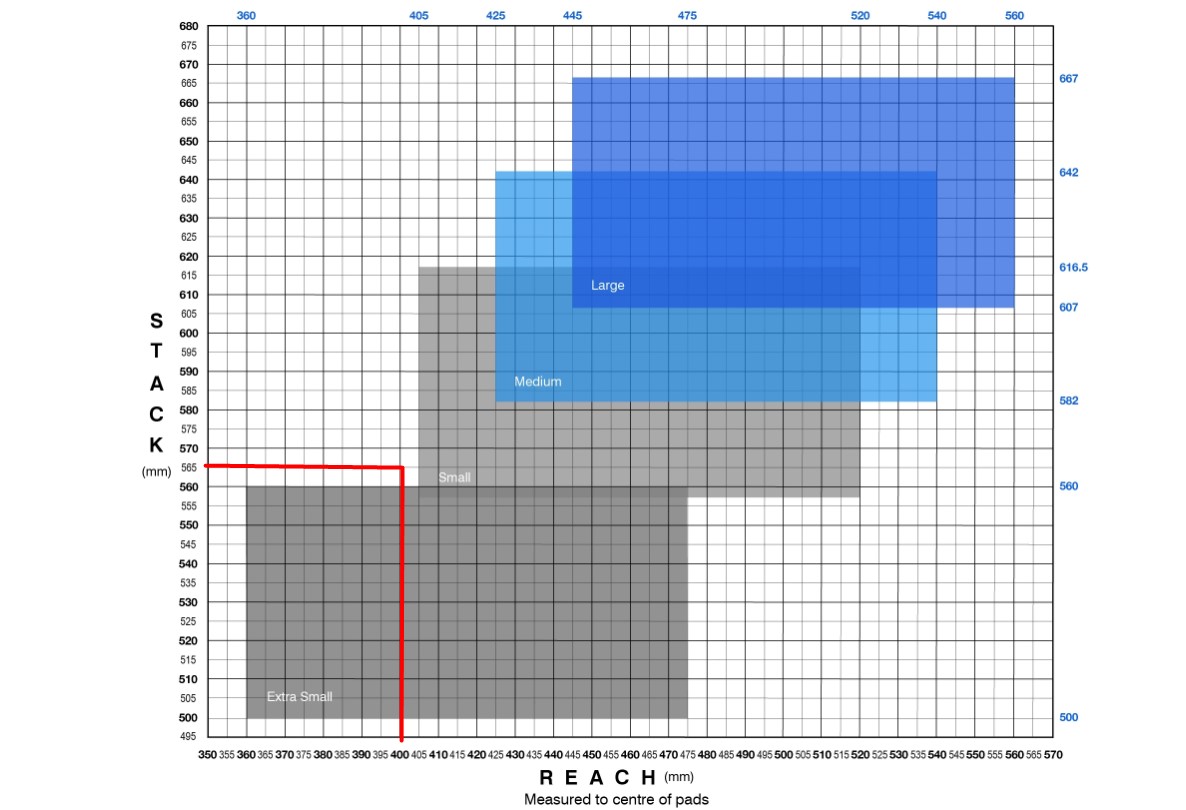

Most tri bikes have a chart that shows the range of adjustability for each frame size (using the stock cockpit). Here’s the one for the Cervelo P5X:
https://www.cervelo.com/static/version1574446879/frontend/Cervelo/default/en_US/Cervelo_PfivexFit/images/P5x-Pad-Stack-and-Reach_ForLight.png
As you can see, there is overlap between sizes. You want to be toward the center of the range if possible (esp. for reach, since there is impact on handling).
