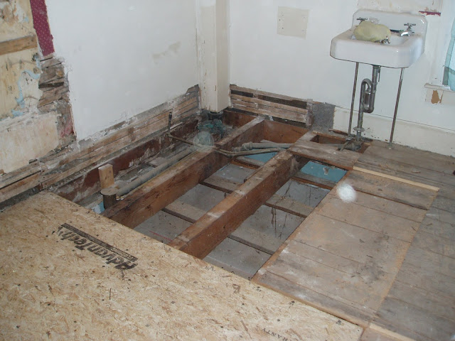

Finally have my photos uploaded to the web, so here are some pics of the new bathroom I built in the rental house. (You know, back when I was belaying bathtubs down flights of stairs.)
Before:
https://lh6.googleusercontent.com/-1FvifKtzW7A/TqXpYXF_6bI/AAAAAAAAAA0/MiVQa0X_IBA/s512/PA200920.JPG
https://lh5.googleusercontent.com/-QlHLNDHXdqE/TqXpZMmHVXI/AAAAAAAAAA4/GQ-BBl9SYvQ/s640/PA200921.JPG
During:
https://lh6.googleusercontent.com/-84oHeNZV6oM/TqXpfaFLU2I/AAAAAAAAABc/Jms1wlMVQS4/s640/PB240989.JPG
https://lh4.googleusercontent.com/-8-rK76gE9Pw/TqXpmV89s0I/AAAAAAAAACI/SKmqH0zfe2k/s640/PC071000.JPG
After:
https://lh4.googleusercontent.com/-rKUs1_nP0zE/TqXpu-F3W7I/AAAAAAAAADE/gGINVH0u-ak/s512/IMG_1746.JPG
https://lh5.googleusercontent.com/-sd0160L9YdE/TqXpvcMGYqI/AAAAAAAAADI/JQiPjmevxTk/s512/IMG_1747.JPG
For what it’s worth, I’m completely self-taught, and have learned everything I know about bathroom remodeling from books and the internet. I did have the advantage of having done one previous total remodeling job. That one came out okay, but this one came out better.
