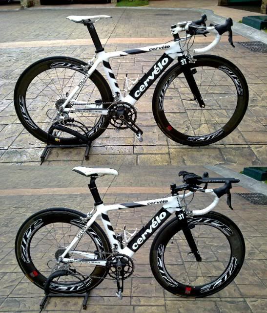

A more impressive build is one below:
http://img.photobucket.com/albums/v236/campled/Cervelos/RCLCerveloSoloist3.jpg
This is the solution of one guy on here, Campled. Admittedly it´s not a P2C but it´s a very, very neat solution with the 3T bars. Just put it up for ideas/inspiration.
Plenty of other pictures of tri machines set up for road bars and clipons, but you might have to trawl a few threads.
Sorry cant see it! Has the picture been uploaded??
Looks OK here.
