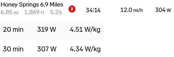

I dug up this post and would like to report my ftp is up from 285 to 304 without gaining weight. Example ride in picture attached. Workouts focuses on vo2 max rather than ftp helped. (plus 1 legged leg presses). I still think I look underweight. anyways, my 1 minute and less power is still my weakness.
