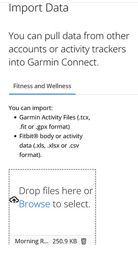

Anyone successful loading a Form fit file to Garmin on an iPad? I downloaded the fit file and can see it on my iPad “Files” app. When I try to upload on Garmin’s website from Chrome, when I Browse, the fit file is greyed out. I tried to share it with the Connect app, but that goes to “course” selection and doesn’t upload.
Any guidance is appreciated.

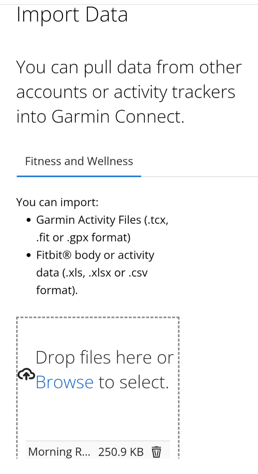

I realized that when I look at the upload for Garmin, spreadsheet files are the only ones not greyed out. So I used Form to download the csv format. After unzipping it, I have a nice .csv file. But unfortunately Garmin pukes in it and gives an error. It doesn’t give any details, just a generic message that there was an error when trying to upload.

If you go to the Files app after you download from Form and tap the zipped file, it should unzip for you to the .fit file, which should be upload-able. Is that the process that isn’t working?
Correct. It uncompressing the zip file, creating a fit file. But that fit file will not upload on Connect.
Seems like it should, but doesn’t. I can’t imagine I’m the only one who’s tried this. That’s why I was asking - just trying to see if anyone does this successfully and what steps they do.
