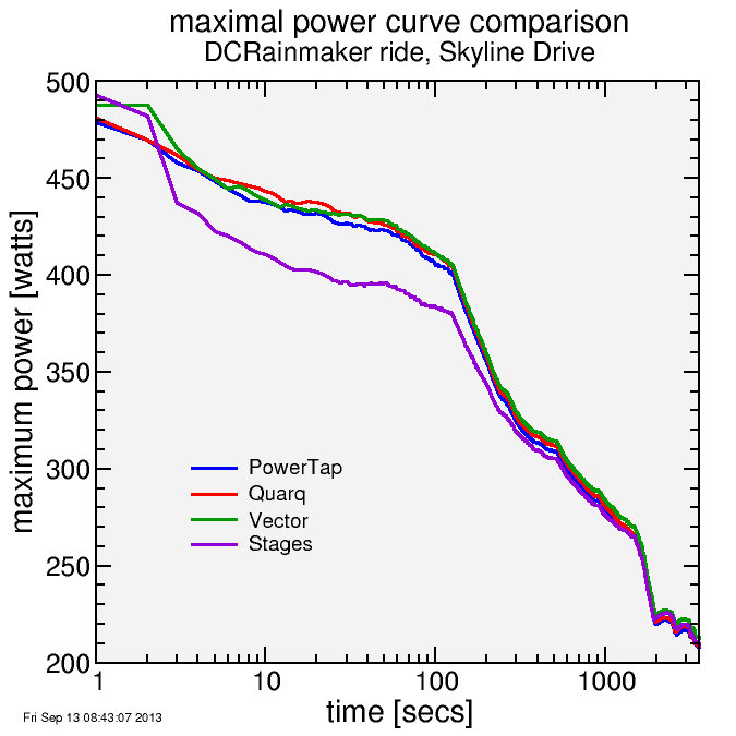

The accuracy of the measurement hardware is meaningless if there’s a systematic (such as a time-varying left/right power ratio) that causes the estimate of the power to be biased. Having used neither, I would not at all be surprised if, in the real world under real pedaling conditions with real riders, the Quarq provides a more accurate estimate of the power applied.
Because the stages only measures power from one leg, and the power balance of a person’s legs right vs left is not consistent.
So, you don’t know how accurate your power meter has been. It might seem like it is outputting reasonable data, it might even seem to be matching up with another power meter if you just glance at it while riding.
But then you dig deeper and you might find something like this:
http://www.dcrainmaker.com/images/2013/09/max_power_curves.png
But that is just DCRainmaker’s legs, that seem to be more unbalanced at higher, short term power outputs, on that day.
Yours might be different. Pedaling asymmetry is normal, and variable:
http://www.ncbi.nlm.nih.gov/pubmed/10460126
http://www.ncbi.nlm.nih.gov/pubmed/979569

Well 2% about doubles the amount of error, and then is no reason to expect it is always going to be 2% at all power levels, all fatigue levels, and every day.
If I can use both and not notice a problem in accuracy… Then why would the inaccuracy matter? How the units compare to eachother is irrelevant. all that matters is that the unit is consistent to ITSELF. You’re kidding yourself to argue any different.
Right, if a power meter is consistent with itself, it will be a great power meter, because such a power meter can simply be calibrated and be accurate.
But left/right power balance is not consistent. It varies with fatigue, output, and from day to day. Thus the stages will not have consistent error.
Such as is clear in the graph above, where DCRainmaker was off by 30 watts for ~1 minute efforts. You probably wouldn’t notice that error until looking at the data afterwards, but there it is. It isn’t going to be like that for everyone, it probably won’t even be like that for DC Rainmaker on every ride he does.
