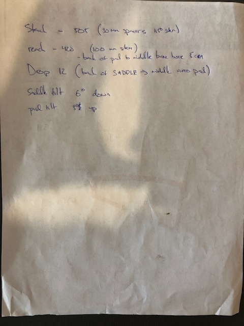

I had an Exit bike fit done last week and am wondering what the coordinates suggest would be an appropriate frame for me. I’ve ridden a Felt IA10 for the past few years and been happy with it but the fitter suggested a P3 or P5 would be better because it isn’t as tall. I would prefer to stick with Felt if it works just as well as other options. What do you think based on the attached fit coordinates?

Stack: 505 (30mm spacers, 115-degree stem)
Reach: 420 (100m stem), back of pad to middle base bore 5cm)
Drop: 12 (back of saddle to middle aero pad)
Saddle tilt: 6 degree down
Pad tilt: 5 degree up

Assuming 635mm is the pad stack and the pad reach to the center of the pad is 470mm (420mm back of pad plus 50mm to center of pad) you would fit nicely on a 56cm IA with the integrated front end according to the Felt Fit Calculator. You could also fit on a 54cm IA but it would require a lot of spacers and the pads would need to be set too far forward.
There seem to be some inconsistencies in the numbers of the two images you showed…
While he put the 420mm in the reach (to center of head tube) slot on the worksheet, apparently he meant it to be pad x but left that spot blank, as he labeled back of pad in both images.
But he shows 635mm stack (to top of head tube) and then on the back he says 505mm stack (he does not specify if that is actually stack this time, or if he means pad Y)???
He should be able to say, yes a Felt IA can get you in that position with these various options in setup or no it cannot. Just saying I like this bike best and this other bike 2nd best I’m not sure is useful.
Edit - Also, he says saddle height is 76? Does he mean seat tube angle?
Edit again - it seems he must be giving some measurements in mm and some in cm. But none are labeled. And since he is clearly putting some measurements in the wrong spots, leaving us to guess what he means, when you add in changing units without labeling…

Still, a good fitter should easily be able to give you multiple options that will work and tell you exactly what specifics you’d need for each. While this person may be qualified and your fit might results might be good, the lack of attention to detail evidenced by the mis-labeling and mixing of units noted above by RowToTri is a bit concerning. It doesn’t quite measure up to what I would consider professional.

Sorry for the confusion, everything is cm except for the 420 pad reach and the 635 pad stack. The 76 is saddle height not angle. Sorry, my ADD gets the best of me when I enter data. Felt is certainly a close second with less spacers involved. I like the fit of a cervelo better since it seems more appropriate with his coordinates
