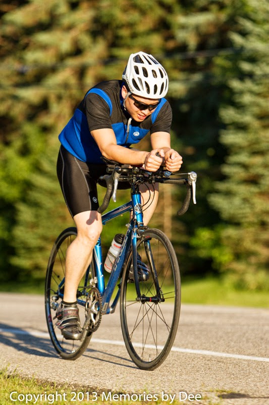

I ride a Domane with clip-ons. My position is about as unaggressive as it comes, but I’m super-comfortable. I have the seat post flipped and the saddle all the way forward:

I run a Domane 5.2 with clip-ons, I want to say I am a little lower than you but I can’t find a picture of my profile on the bike right now. At any rate, it is plenty comfortable and I notice some added efficiency when I am resting my arms on the pads. I was thinking of moving to the red-shift system instead of flipping the post around.
