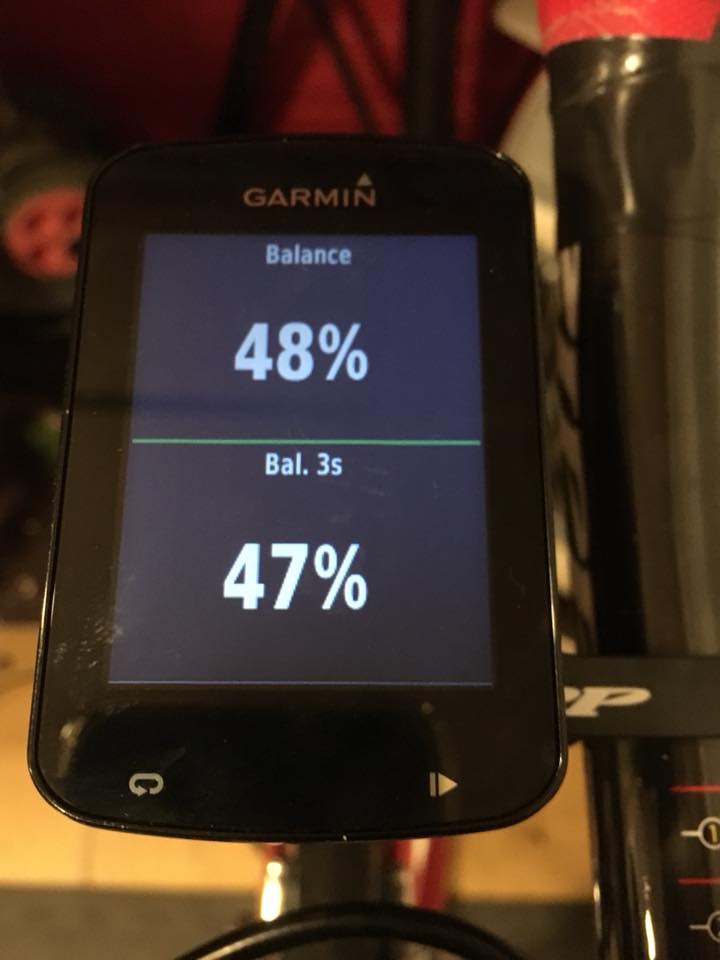

How can I get left/right balance from Direto to Garmin 520 or 935?
Can anyone help me ?
You can’t, it’s only available in their app if you pay.

He can indeed, when paired as powermeter it broadcasts L/R balance and you can setup a data field to see it.- No other pedalling metrics though. Also, if you don’t have the wired cadence sensor (optional) the trainer does not know what is right and left so the value could be inverted (but you can easily figure it out unbalancing the stroke on purpose.

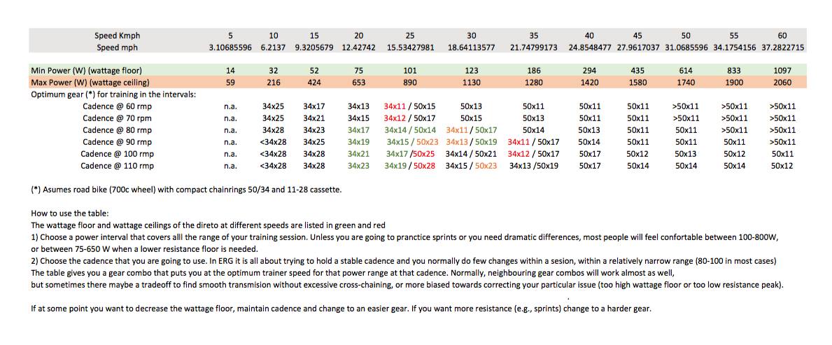

can anyone tell me roughly what the wattage floor is, say, for the big ring and 25 tooth? I want to buy one, and dont really want to do intervals in the small front chain ring in erg mode.
Can you get buy under 100 watts on the big ring in erg mode or are you changing gear?

I made this table some time ago so you can figure it out. Big ring is a 50 compact here. Short answer is yes if your cadence is below 85 aprox
That’s an awesome table! I wonder what 53 would look like across the board
