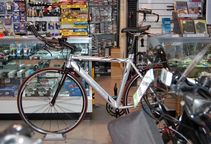

Here is the bike without me on it. The frame’s seat tube angle is only 75 deg. and seat post is the rear mount type, so yes the saddle can come forward a whole lot if I swap to a centre/forward mount post.
(The tip of saddle is currently 45mm behind BB.)
http://i65.photobucket.com/albums/h218/blxpy/norider.jpg

Looks like your bars are too far forward…need a shorter stem

And you don’t need to go forward more, but rather have a shorter top tube and taller head tube.

What am I missing here? His saddle is mid-way on the rails on a setback post on a 75 degree bike with what appears to be a 120mm stem. That looks like almost three inches that could be taken out by straight seatpost, saddle forward on the rails getting you in the 78 degree (?) range and 100mm stem… that wouldn’t work? I’m thinking it would, but then again I think that fitting someone by pictures alone is sorta silly :wink:
Don’t forget the shorter extensions on the clip-ons.
Your saddle has a ton of tilt to it. For me, if my saddle is set up like that, it forces too much weight on the aerobars.
