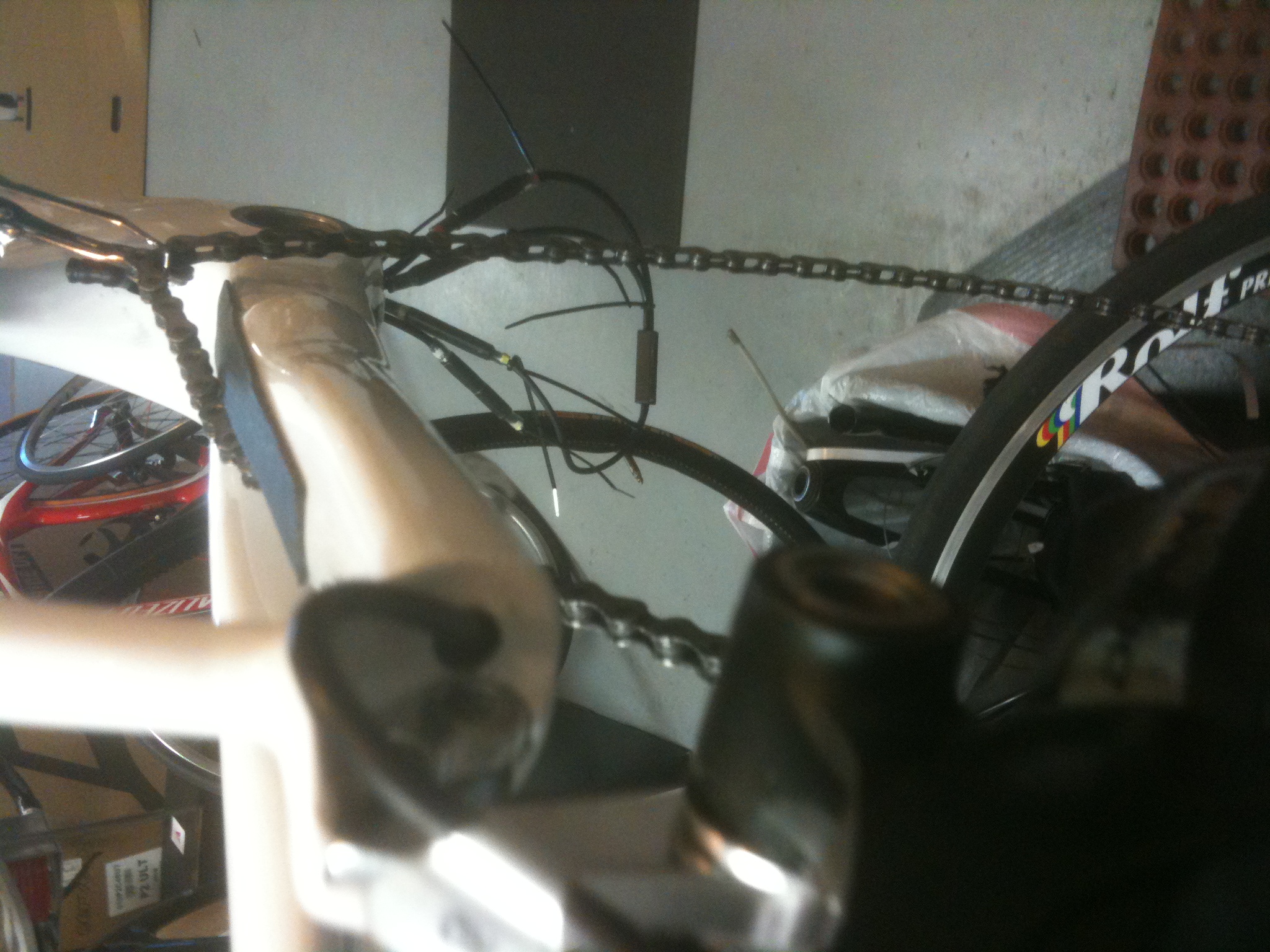

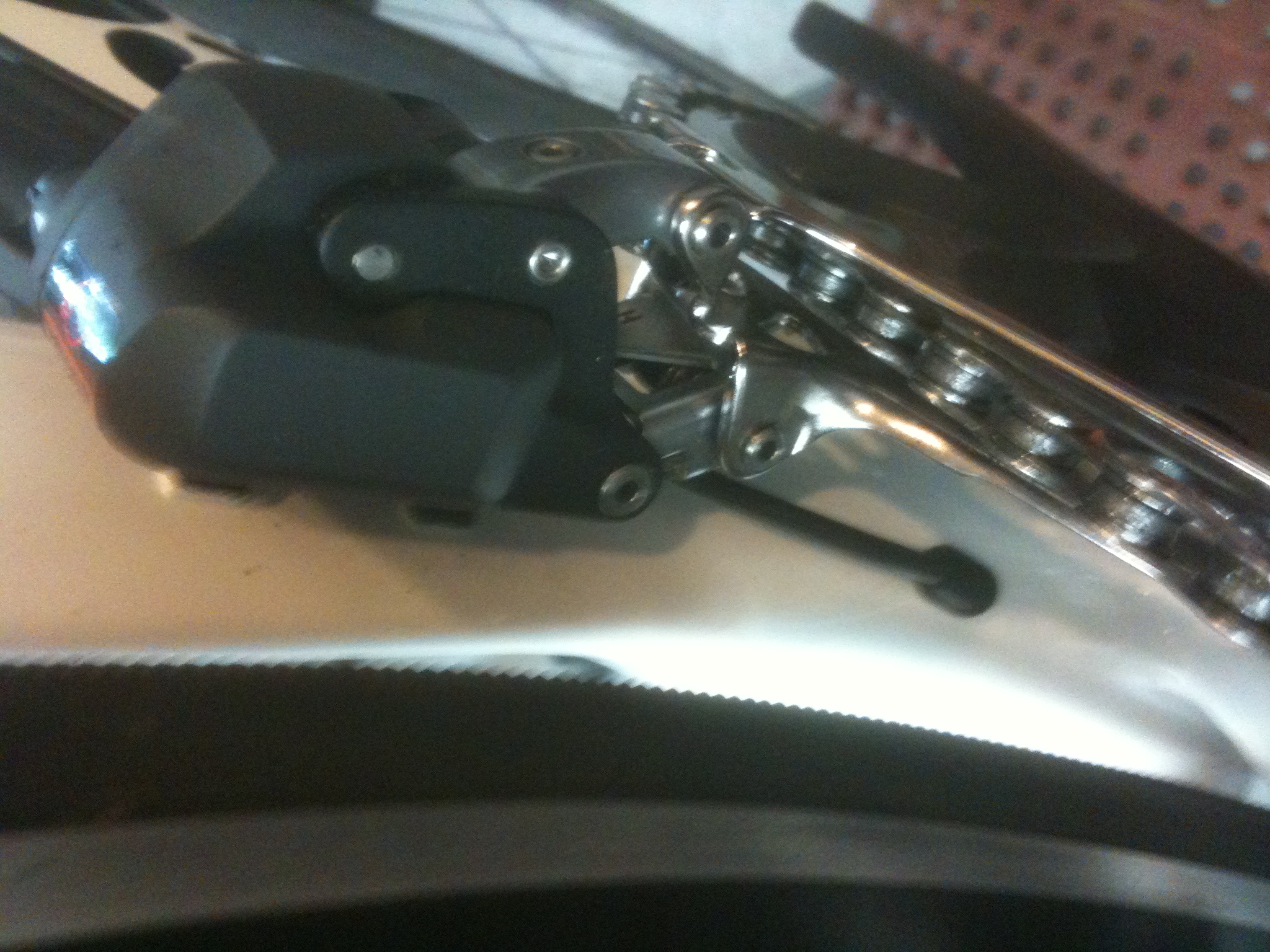

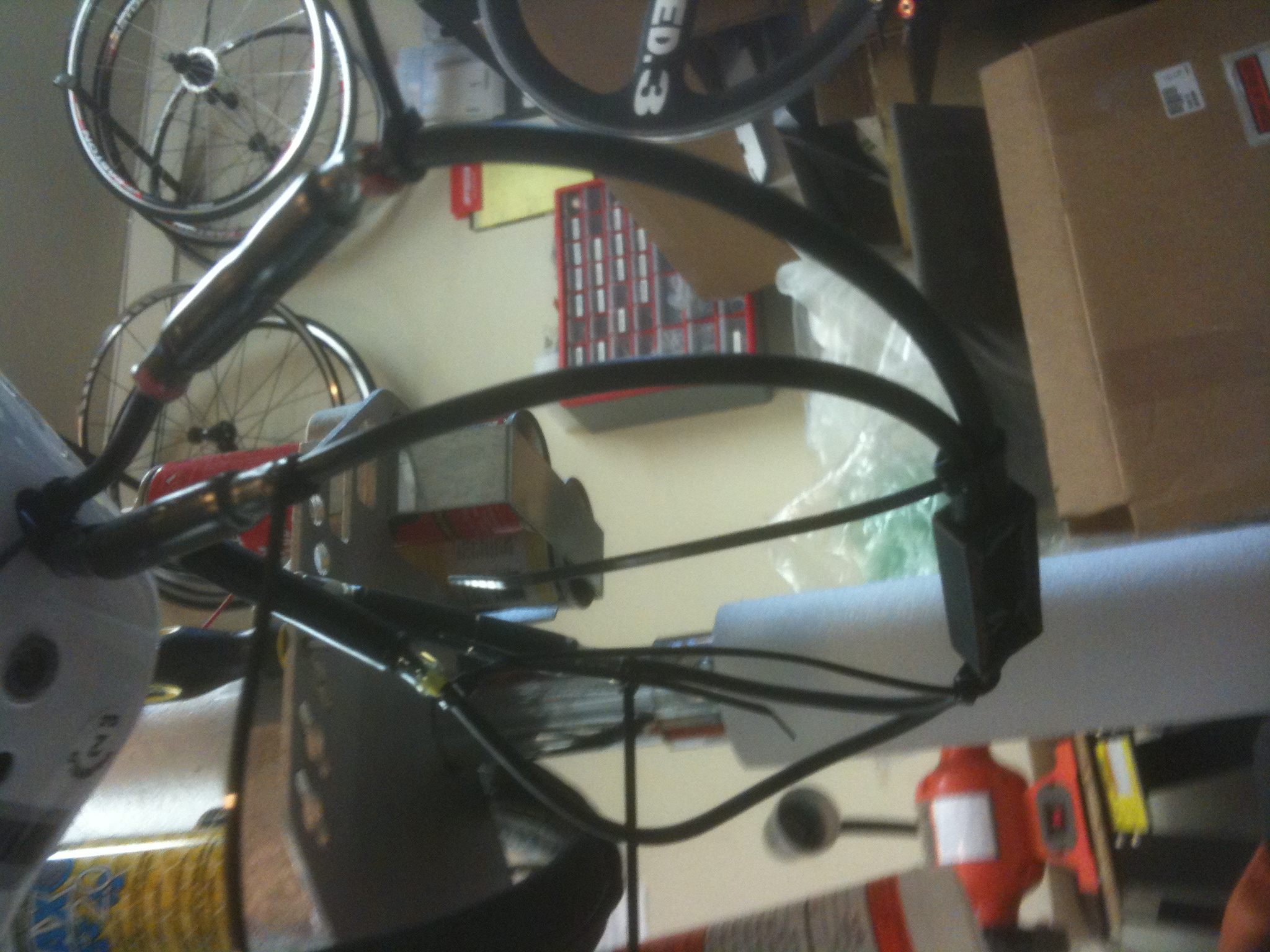

On a P2 you would have to do a lot of drilling to get the holes in the correct places. I would be hesitant to do it as you would have to put a sizeable hole on the drive side chainstay to get the wiring to the rear derailleur. The other issue with the P2 is that the hole on the bottom of the down tube is smaller than that on a P3 so to get the little junction box piece in would be difficult without making it too big.
If you were going to do it I would put the wire for the rear der. externally. That’s what I did for another customer’s P3. It really depends on what is possible with the frame.
Attached are pics of a S3 that we wired fully internally last week for a customer. Keep in mind that the BB and chainstays are different so it was pretty easy on the S3. There are a lot more pictures of the before and after on our website so take a look to get an idea. They’re in the 2010 bike gallery section. LINK
http://www.frontofthepack.com/portal/images/s3/s3rings_di2%20002.jpg http://www.frontofthepack.com/portal/images/s3/s3rings_di2%20007.jpg
http://www.frontofthepack.com/portal/images/s3/s3rings_di2%20015.jpg
