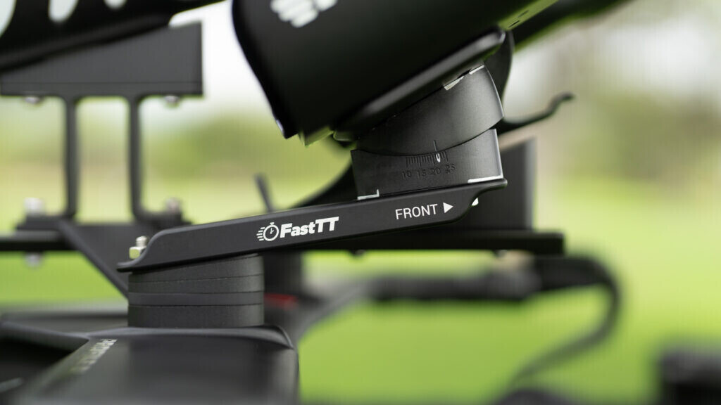

The longer stem version is because I want to offer a range of fit options. As it turns out, that will be particularly helpful for Ventum and they’ll be able to offer the Wing Ultimate L as an option.
I’ll just point out that using aftermarket parts on PD basebars voids the basebar warranty and is completely at the riders own risk. Reach extenders in particular are a major concern. PD parts are tested to be a safe ecosystem, 3rd party components are a huge unknown.

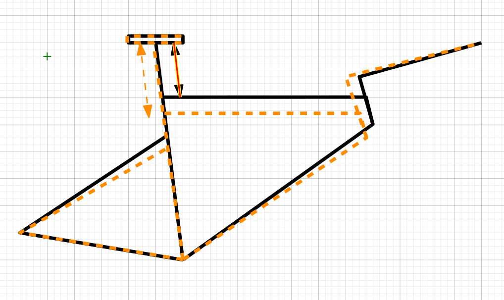

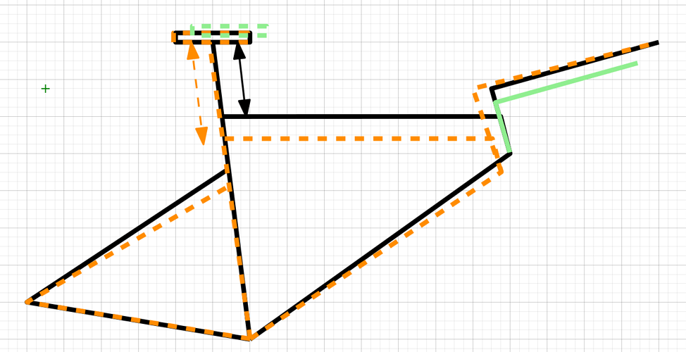

My logic with frame size:
Here orange and black achieve exactly the same saddle position with respect to the bb and by having a longer aerobar at the front the same reach is achieved as well. The main difference here is that ugly tricks are necessary to achieve orange, whereas on the black frame no reach extenders are necessary. Would your argument go to the green setup?
Yes, sorry, after I read it back it sounds like the longer stem version was specific made for the Ventum, that’s not what I meant. I meant it should really help the Ventum in getting more reach without the need of extremely long after market extenders.
And if needed it can still coupled with the reach extender in a safe way.

Large Argon18 E119tri+, full FastTT front end (adaptor plate, angled mounts, reach extenders, and XL aero bars) and at 190cm and 75kg and as far forward as I can legally go and it’s been holding up great once you get everything tightened and carbon pasted.
The big difference is my risers are bolted into fork, not into the basebar. I have more confidence in my system than hers, but she is significantly smaller than I am.
