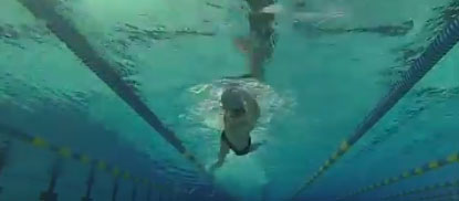

Hi, I took my first video and was hoping it could be critiqued (shred me please)!
Background: Lifelong runner trying to swim. Started swimming 8 months ago, current 1500m LCM at 27:27, 100scy at 1:18. The video is of me roughly swimming at threshold pace. I find I am always significantly faster (15s/100) in my wetsuit OWS.
Broken left collarbone 2x with known mobility issues in that shoulder, generally very inflexible anyways. I have been diligently doing the 1 arm drills w and w/o snorkel and stretches with my shoulders to help flexibility. I feel that I am very bad with streamlining and straightening my arms and body in the water.
Any tips on issues to tackle and what drills I can best do to address them greatly appreciated. Thanks!

  1. note this image below, a screenshot from the video of you. note the leg splay. this is directly related to how you breathe. you need to get rid of this.
note that you roll entirely, like a plank, when you breathe. hackett’s movement, when he breathes, doesn’t much extend to his body from the waist down. his feet continue, mostly, to push down toward the bottom of the pool rather than toward the sidewalls.
how do you fix this? by A) working to keep your feet kicking down, even when you’re breathing, and either tether your feet entirely together, no kick when you swim, or tether them loosely together, requiring you to kick, but without letting your legs splay like that.
  1. your first movement after the catch is a bend at the wrist. i get what you’re trying to do. but again, watch hackett’s video. there is no bend in the wrist. the bend is at the elbow. in fact, finis makes not one but two different paddles specifically designed to not let you bend at the wrist.
so, overall, good. but keep your feet kicking down all the time, get rid of that splay, and perfect your first action after the catch and extend, that is to say, establish that pulling surface (elbow to fingertip) correctly.
all that said, if tigerchick or halfspeed or monty contradict me, or if gerry rodrigues or gary hall sr come on the board to tell you i don’t know what i’m talking about, listen to them not me.

Thanks Slowman, I had no idea I splayed like that! That explains why the 1 arm drills are so much easier with a snorkel too. Time for more band work.
You’re right, I’ve been consciously bending my wrist then elbow. I have the yellow Finis agility paddles, are they the right tool for adressing that portion of the catch?
i’m going to defer to some others who’re better than i am at diagnosing. but while they’re deciding what to diagnose and what the remedy is, here are my observations:
  1. you’re doing everything “right”. you’re a good student. you learned the dance steps. now we just have to inject some rhythm.
  2. you’re a dutiful bilateral breather. that has helped you to make your stroke symmetrical. but, oxygen is your friend. no need to bilateral breathe. there is a need to breathe on both sides, but not to bilateral breathe.
  3. you are a poster child for the drills in the Guppy Challenge. your feet are on the surface (mostly) but you’re not getting anything out of them. if you watch videos of “hip driven freestyle” you’re not getting that propulsion from your lower body. so…
  • kick drills; one-arm pull drills (as explained in the guppy challenge); banded ankle swimming (band your ankles, float your lower body, and swim). those 3 things.
  • at least one of your hands enters the water crossed-over, and then straightens out after it’s in the water, as you’re extending. your hands need to enter the water in front of your shoulders. the catch needs to be an affirmative, purposeful act.
let’s start with this.
there are 2 finis paddles that are specific to this. one is the bolster paddle, and the second is that figure 8 thing. but the agility paddles are good as well. just, the agility paddles won’t solve this. i don’t think you need to get a new set of paddles. just, now that you know you’re doing this and that you shouldn’t be doing this, i suspect you won’t find this difficult to solve.
