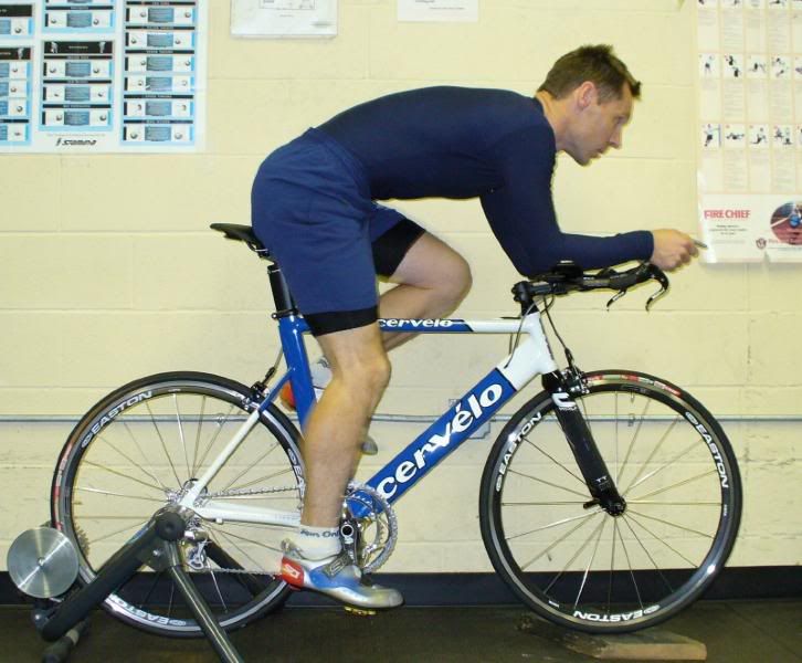

Yes, it is one of the $599 2004 Cervelo P2K’s in size 54.
I am 5’ 9", 31" inseam. Kind of long torso/short legs.
I took the measurements from my old bike, and tried to make it the same.
http://i100.photobucket.com/albums/m9/dagjostein/P1000858.jpg
The seat hight feels great, no rocking of hips.
My sholders on the other hand, always sway a little side to side when I apply power, as in these pictures.
http://i100.photobucket.com/albums/m9/dagjostein/P1000854.jpg
It feels great, but any suggestions are welcome.

I know it’s a cliche, but seat too high?
no it is not…

I have the same bike, circa 2005, and am about the same measurements. I love it. Your position looks aero, but you need to tuck in your knees closer together when pedaling. Also I’d try to raise the seat up about the amount of the period at the end of this sentence.

Position looks pretty good. Only comment I have is that it looks, to me, like you are too far forward on the bike. Not much, but, it appears your center of gravity is too far forward on the front wheel. However, I notice you are riding high on the nose of the saddle. Do you always ride that far forward? Looks like if you slid your butt back on the seat (not much), you would be perfect.

It might be due to camera angle in the frontal pic but your left forearm /elbow looks higher than your right, check distance between bottom of armrest and top of bar?
I changed to these parts:
Fizik Arione seat, Vision flat base bar and brakes, 170 mm Truvativ Roleur Carbon crankset with a GXP bottom bracket.
One interesting thing to note is that you got a brand new Wolf carbon fork instead of the one originally shipped with 2004 Cervelos. This makes the bike an even more smashing deal! Good luck with it!

Shoulders rocking ? That’s generally your self control…not the set up. Work on it or else.
Oh, yeah I forgot to take off the “modesty” shorts. Not to popular walking around the firehouse showing off your “package”. They are probably jealous…
Just went out to check the bar and pads, they are even, I am not…
